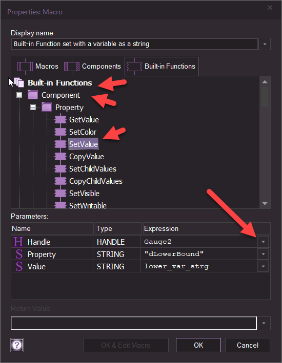

double click on lowerband shows the variable name
or right mouse button click copies the variable name into the clipboard
And then i can choose a way to change the value:
directly with a string
or if I need to calculate via a "caculate comand" and use an integer variable and string variable

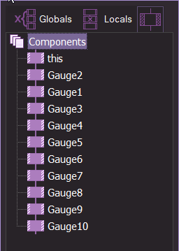

And the Handle I can found under the
A list of the handle:

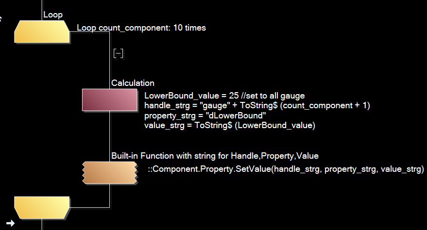

Here's another idea...
Sometimes when I have a lot of the same component and want to change propertis, it is even easier (maybe) to do that
comfortably in a loop....

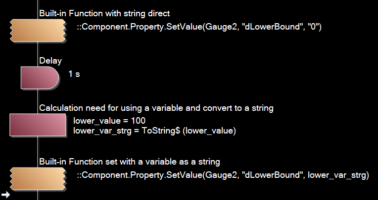

To make it so there is less work involved, even though it states String for a value within the built-in functions, it does not have to be a string.
You can use ints floats literals etc., so there is no need for the ToStrings function.

Hi Martin
Fanatastic, yes that works! With the value or with a variable it works perfectly. That makes it much easier. Thanks Martin

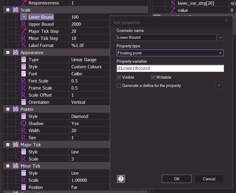

One thing to bear in mind, the Property entry is the exception, which must be a string or within speech marks.
If you look at component sources, there are plenty of examples using built-in functions.
