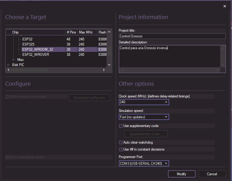

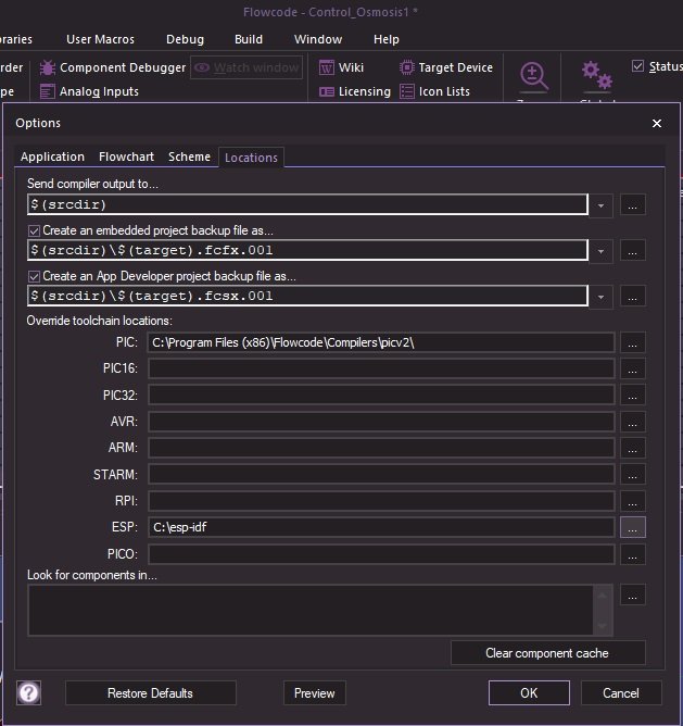

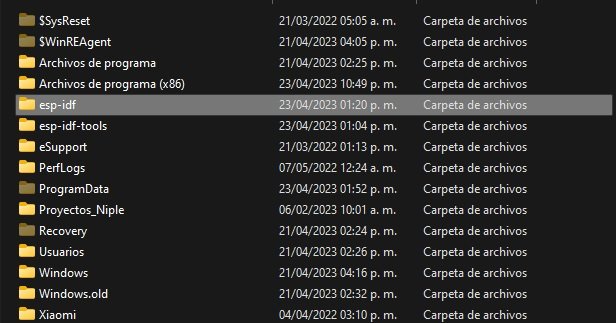

Hello, I am sending you images of how I am building, the previous answer, the file is the last one I sent, I am also sending you the results of the last construction, I see that it is because some components show an error.

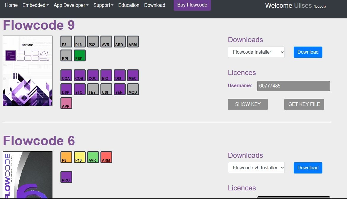

I would like to know if this is because of the issue of the license?
And if I buy version 10 with a professional license, will this work?
