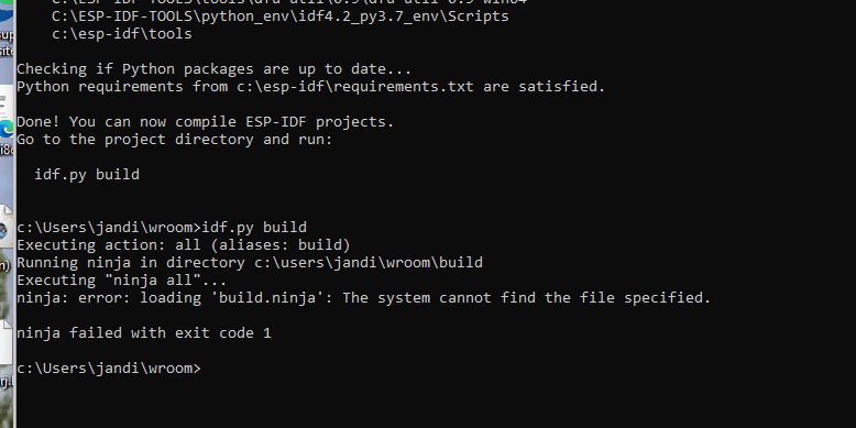

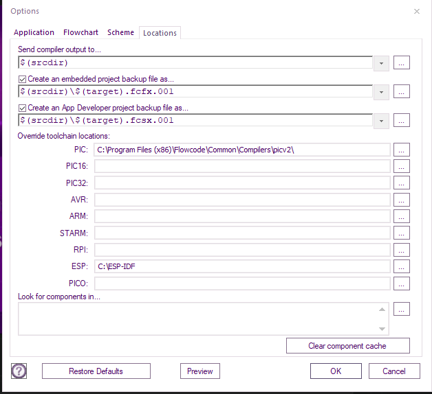

Re: Installing and setting up of ESP32 toolchain
Yes, location in FC still set to C:\esp-idf
Checked environment variables, there's a C:\ESP-IDF-TOOLS ; don't see ESP-IDF on itself here.
Did notice a system variable "C:\Users\jandi\AppData\Roaming\Python\cripts' seems a typo, no idea of the possible impact. Left it at that.
Install of esp-idf ran successfully. Export ran successfully as well.
idf.py build gives the same error I see before: ninja failed. See attached.
The folder ....jandi\wroom\build does exists and has the bootloader and CMakeFiles and config etc subfolders.
