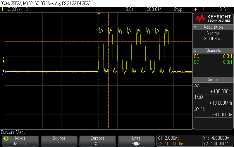

I checked the initial clock speed from the sd-card clock pin and it was 10Mhz (like the display clock)

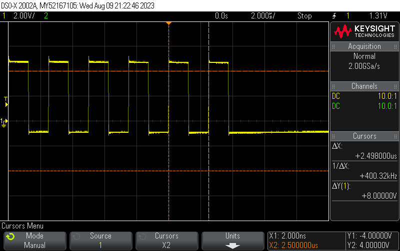

I actually expected 400khz like the config from the sd-card. So i changed the clock from the display to 400kHz and the SD-card clock was 400khz

I did also the last update, it's the same.

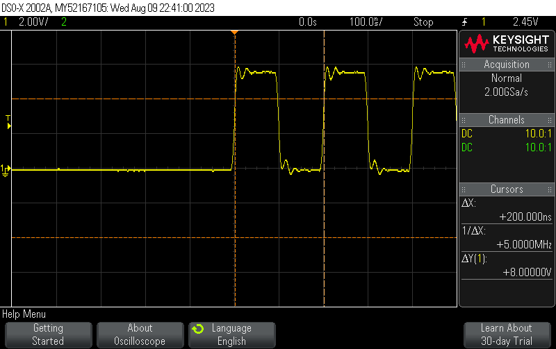

I set all the clock to 5Mhz (also the initial clock SD-card) and then it's working
And it's a 5Mhz clock

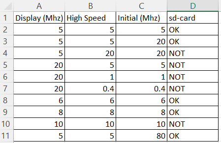

Testresult with different spi-speed
It's look like the sd-card Initial speed properties has no effect to the card, if on the SPI bus are a display and a sd-card.
With the disadvantage, the display and sd-card are both slower, they cannot run at their maximum speed.
and the special thing is that it actually works with a wrong (80 Mhz) initial speed.

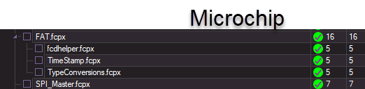

I get my PIC32 Board and made a test. There the initialspeed is working on the PIC32 nice.
Both PIC32 and ESP32 have the same version of FAT.

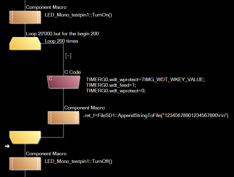

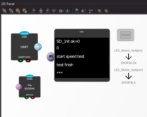

Here is my test
I reduce the number of test to 200....
It's need 1 second
Here is my test
It's need 1 second
