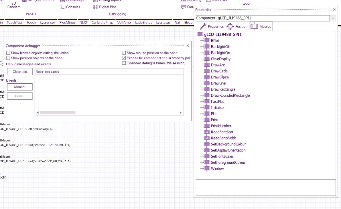

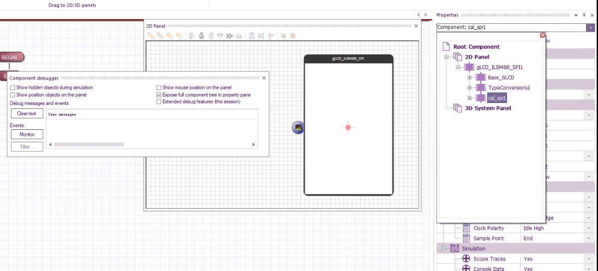

Go to view and Component Debugger, inside the new Component Debugger window tick the Expose full component tree item.
Next go to the properties window and click the drop down at the top. You're looking for the CAL SPI component nested inside the display component.
Once you have selected the cal_spi component look at the Clock Phase and Clock Polarity settings. Try changing these values until the hardware is working again. Once it's working please let us know which settings you're using and we can apply them here as the defaults.

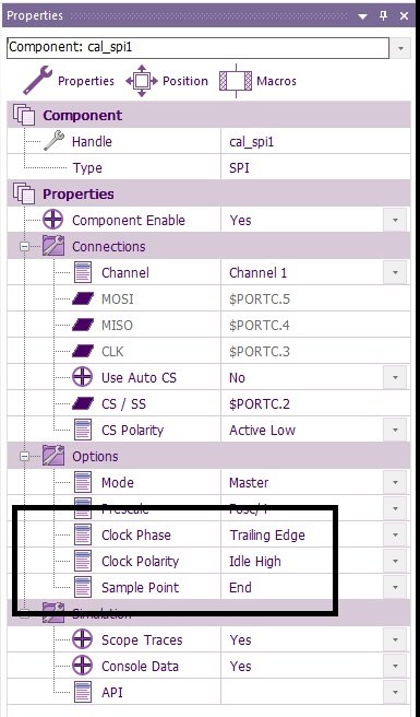

Ok I have tryed to find the Cal component, but I think I miss something, please guide a bit more I not sure that I am on rigth way, and I will try your suggest

So far so good Ben I can´t find the Clock Phase and Clock Polarity settings, if I do how do I edit in these?

Already done, but no Clock Phase and Clock Polarity settings.

No, don't do that, that is a guarenteed waste of your time.@ Ben, will it work if I uninstall FC and reinstall?
You need to be on the Properties tab of the properties window, then use the drop down menu at the top to look inside the display component.
These are the properties of the cal_spi nested inside the display. I've highlighted the ones of interest.

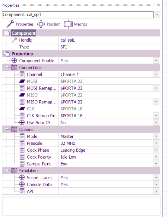

Finally I found the SPI in the path.
After trying different setting with Clock Phase and Clock Polarity settings, "the sun project" seemed to work again as earlyer, wow I am saved and can continue with my project. The setting for the sun project (slow) is as att. picture.
But the Highspeed for Ili9488 and ST7796 Display, no matter what I do with Clock Phase and Clock Polarity settings mHz ect. it not work at all, display Blanck?
The ILI9341 Highspeed work..
Jorgen

- Setting SunProject.png (122.69 KiB) Viewed 6918 times
