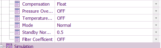

Re: SHT21
Hi Martin!
As promised, when I received the BMP180 I would test, just received them, and hereby, thank´s. I have mad a quick test. I work perfect, but some of the regulation setting in proporties doesn´t make change, the temperature x1 > x16 I don´t see any changing by playing with this. The sleep funktion how does they work, and if the device "go in sleep" how do I wake them up again in the program
Are you kind to give a short explanation for these, and maybe upload a testprogram to Wiki, you are welcome to use mine
And any correction in my test is welcome.
Br Jorgen
Br Jorgen

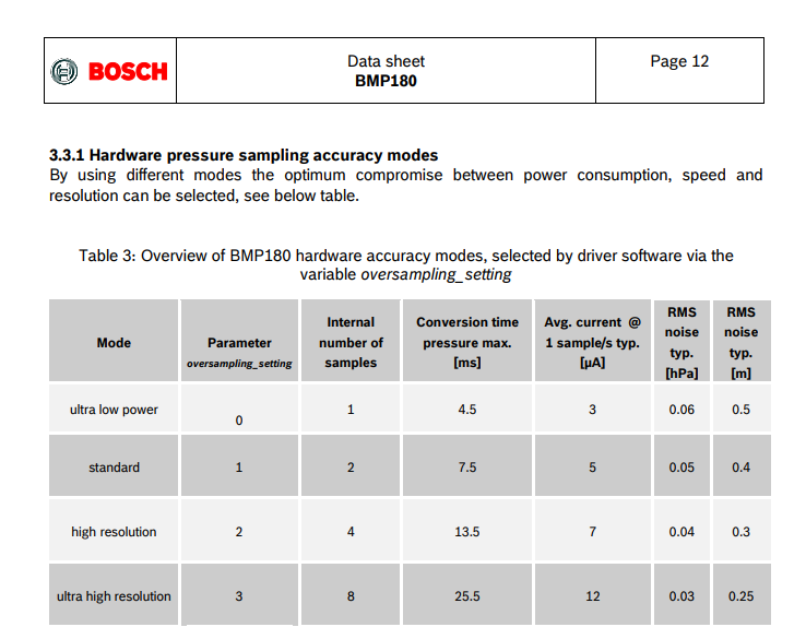

Re: SHT21
Hi Jorgen.
I have looked at the datasheet and temperature oversampling is just a trade-off between accuracy, current drawn, and sample time.: In reality, you probably won't see that much difference if not using a battery.
If you are using a battery to power BMP180, then you want the lowest setting.
As for the sleep, it's to save power when not sampling, it will wake up when being sampled, then go back to sleep.
