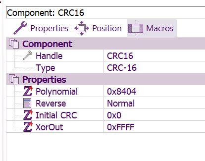

Hi Hermann,
First save the .fcpx file (from the first post) into a directory (for example c:\Flowcode)
Then add this directory to Flowcode's search using 'Build->Customise-Locations'
Okay I have G:\Flowcode (it's a long story - you're probably using C:\ )
Then you need to have your data in a byte array - I've modified your code to do this: I;ve set the polynomial to 0x8404 - if you need to invert the CRC you can either change the value of XorOut to 0xFFFF
or use the ~ operator (and do .crc = ~.crc) Martin

But the result is always wrong
i have for example 9 databyte,
4d 56 57 02 80 00 19 00 00,
CRC-CCITT16 Polynom 0x8408,
the result from other system inverted is 69 CD,
Do you have a good idea ?
i have Flowcode V10,PIC16F18877,
Hermann
Hi Martin,
Sorry i was ill.
Thank you for help
Hermann
- Posts: 2187
- Has thanked: 177 times
- Been thanked: 1027 times
Re: CRC-16 Component
Hi Herman,
I checked using the online checker - mentioned in the first post. There seem to be a range of algorithms / polynomials - and 0x8408 isn't one on that site.
If you can post (or PM) your code = and result you are getting I'll take a look and see if i can work out what is going awry..
