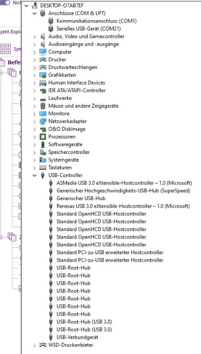

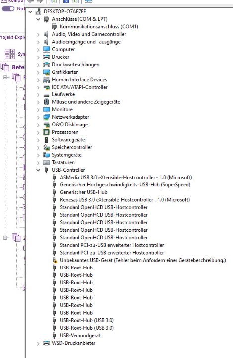

Greetings SpeedPic32
- 13-09-2023 17-39-26.jpg (61.89 KiB) Viewed 10771 times
- 13-09-2023 17-37-00.jpg (62.11 KiB) Viewed 10771 times

Hello together
When the driver is in place, Win 10, 7 and XP recognise it as a Flowcode USB Serial device. The driver is installed and then works normally.
At the moment I can compile in FC9 and 10 without errors but no operating system recognises the device. I get the message Unknown device and error when requesting a device description.
