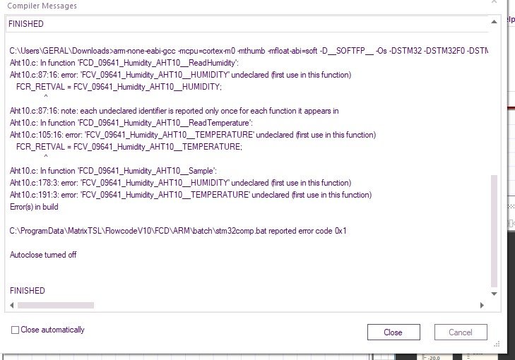

I am unable to compile the code for any of the AHT10 functions. The library is updated, but it is not possible to compile.
Posts: 2325
Has thanked: 724 times
Been thanked: 783 times
Re: Create library for the AHT10 sensor
Hi.
Many thanks for reporting the issue.
I believe I have resolved the issue.
If you would like to try the component before the update is pushed.
Browse to this location using file explorer, it's hidden by default so just paste the link into your address bar.
C:\ProgramData\MatrixTSL\FlowcodeV10\Components
If you run any component updates, then the components you added will be overwritten.
Humidity_AHT10.fcpx
