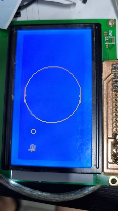

Hi BenR, I made the tests but unfortunately it isn't working.
Posts: 2346
Has thanked: 649 times
Been thanked: 856 times
Re: SPI version of the ST 7920 GLCD
Ok it looks like the MISO pin isn't working for whatever reason. I'll add a buffered mode to the component so we don't need to rely on the readback for the display to function. The buffer will consume a bit of RAM - 1KB for a 128 x 64 pixel display.

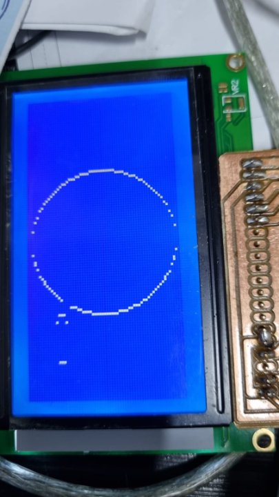

Hi Benr! Thank you for your effort, it didn't work by a thread. The option local buffer made the diference but errors persist.
Posts: 2346
Aha many thanks. I may have spotted my mistake, you can only directly address every even data byte and I had addressed the odd byte the wrong way. Hopefully it will be better now.

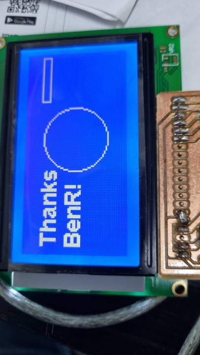

Post by estevaon »
Hi BenR,
You made it! It will be very usefull in my projets, I hope it help others.
