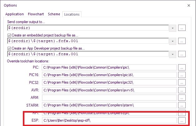

Are you pointing to the toolchain in Flowcode using the View -> Global Settings -> Locations,
The ESP path should contain the path to your esp-idf installation.

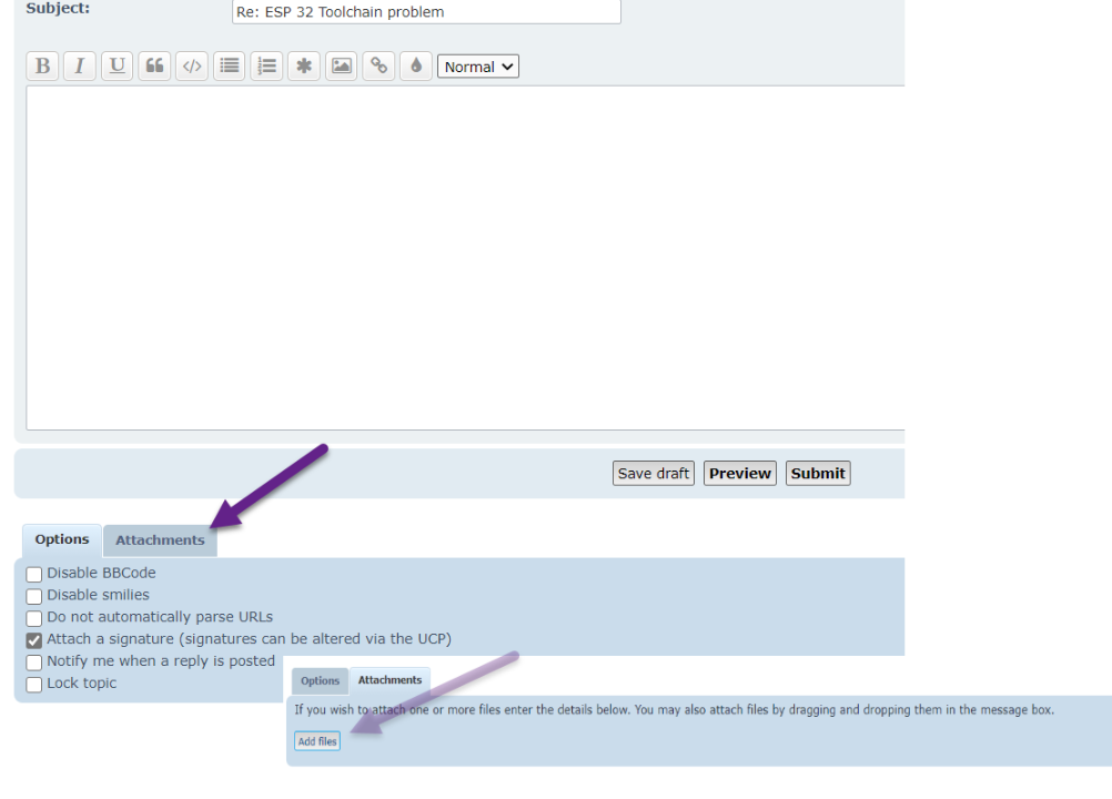

Get the screen with snipping tool from windows and safe it. Press Attachments and add the file.

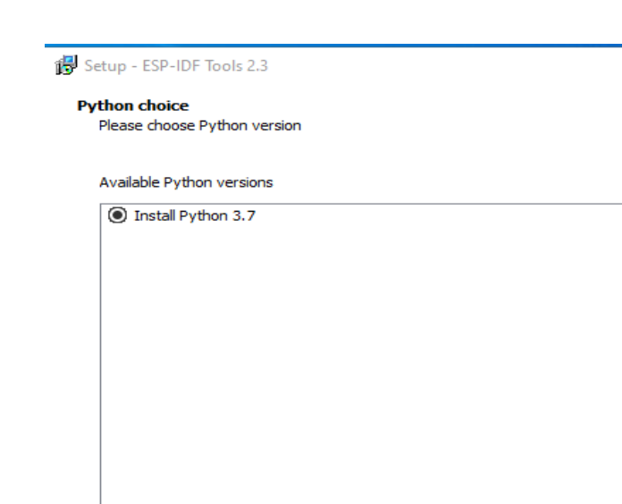

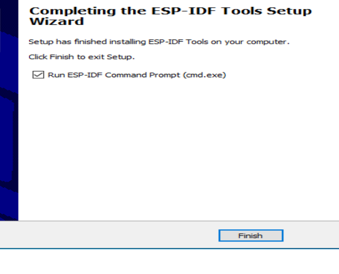

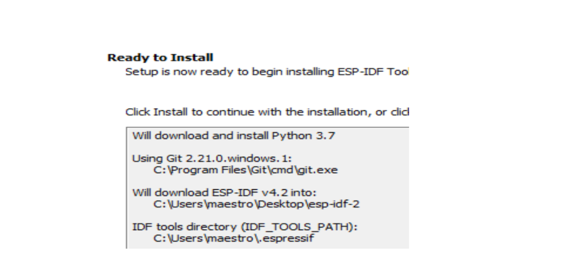

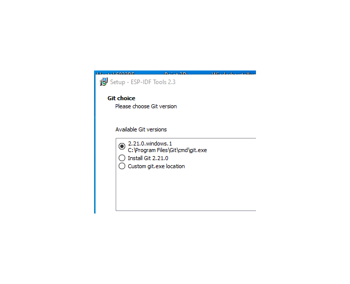

Now while I'm reinstalling the ESP 32 Toolchain, I will document every step
Windows 10 I use in German
Flowcode 9 I use in English

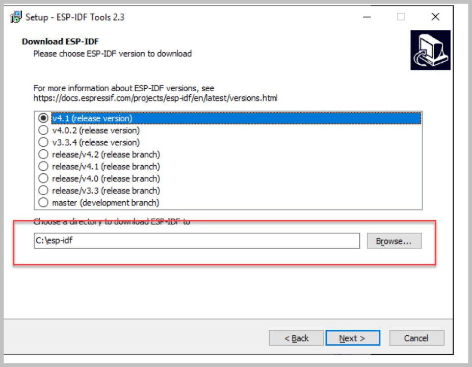

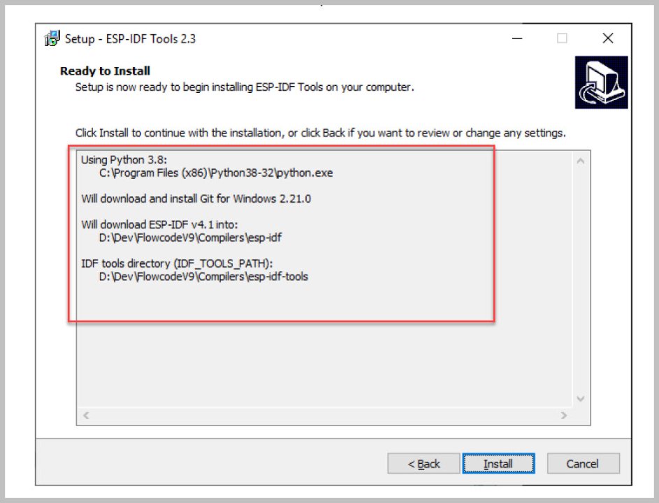

Re: ESP 32 Toolchain problem
3 rd step
Download ESP IDF
4 th step
v4.2 (release version)
5 th step
C:\Users\maestro\espressiv
6 th step
All three additional tasks selected
Download ESP IDF
4 th step
5 th step
6 th step

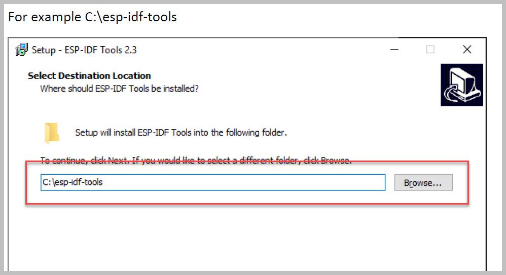

HI

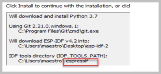

ENTER the PATH s shown below in yourself by hand and make sure at the end it will install in these location
I had to do this !!
For the tools it does not create the esp-idf-tools folder automatically force it by entering it yourself
before you select install capture the locations it will install the esp- idf and the esp-idf-Tools also print the sceen for use as help here,
ALSO make sure the locations is as you enter in the brows section
I had to do this !!
You have the same problem I had
as long as it install the tools in essprif and
NOT esp-idf-tools it did not work with me ,I mentioned force it to C\:esp-idf-tools by entering the path your self in the brows section
look at the screen shots earlier -I posted it will help
