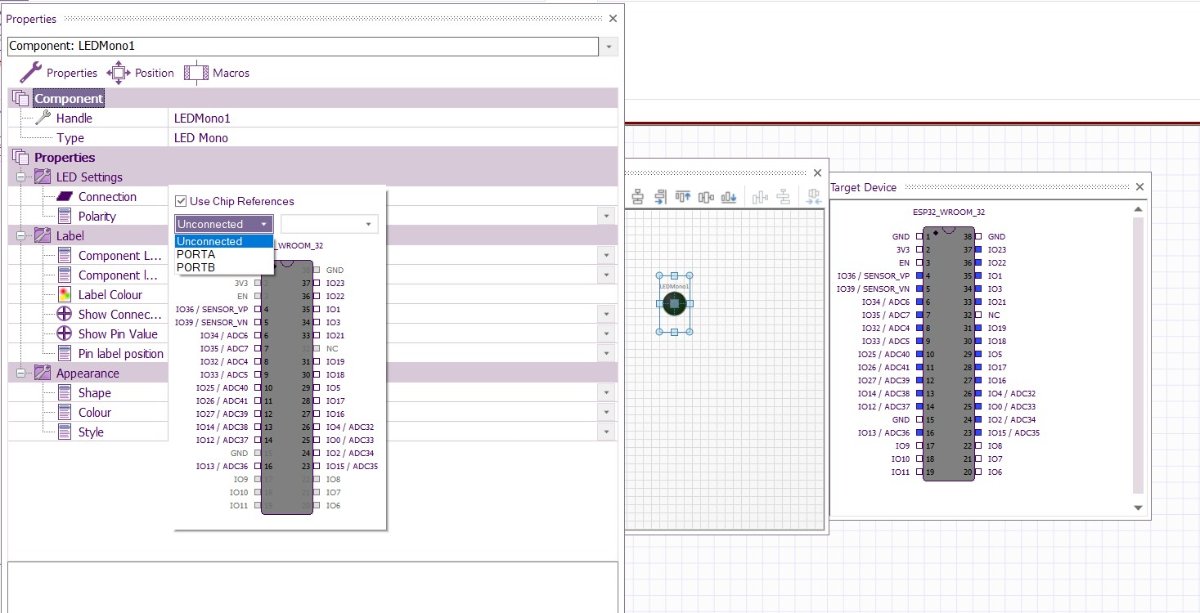

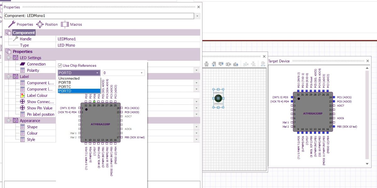

Below is a simple chart I created to illustrate. In it I have a LED connected to Port D0 of a Nano.
I then changed the target to an ESP. However as an ESP doesn't have a Port D it is left unconnected. All I need to do is simply assign the LED to any of the available ports the ESP does have
Much quicker than starting again :D

Ah, ok, got it now... so that information message was just something in case I migrate between Arduino and ESP32. It's more like a feature and not a bug. :idea:
Posts: 2146
Has thanked: 478 times
Been thanked: 713 times
Re: avrdude.exe: stk500_recv(): programmer is not responding
Post by chipfryer27 »
Yep
Pretty much it :D
