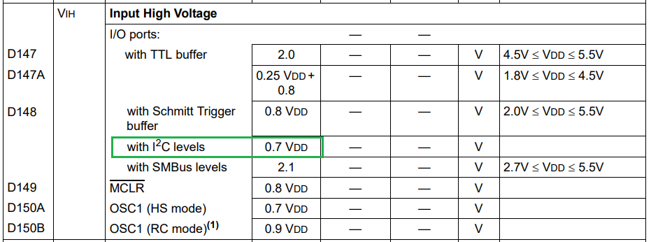

My concern would be what the datasheet shows for the minimum voltage for logic 1 it should be 0.7 * VDD.
Although there will be some safety margin, if measured voltages are out of tolerance that is a high risk, especially if PCB's.
Perhaps try a silicon diode in between 5V reg and microcontroller if nothing is shown for the results of the sniffer.
What I would suggest is erase the microcontroller so all pins change to inputs, then measure the voltages on I2C pins of both microcontroller and BME280.
Are the voltages enough for logic 1?

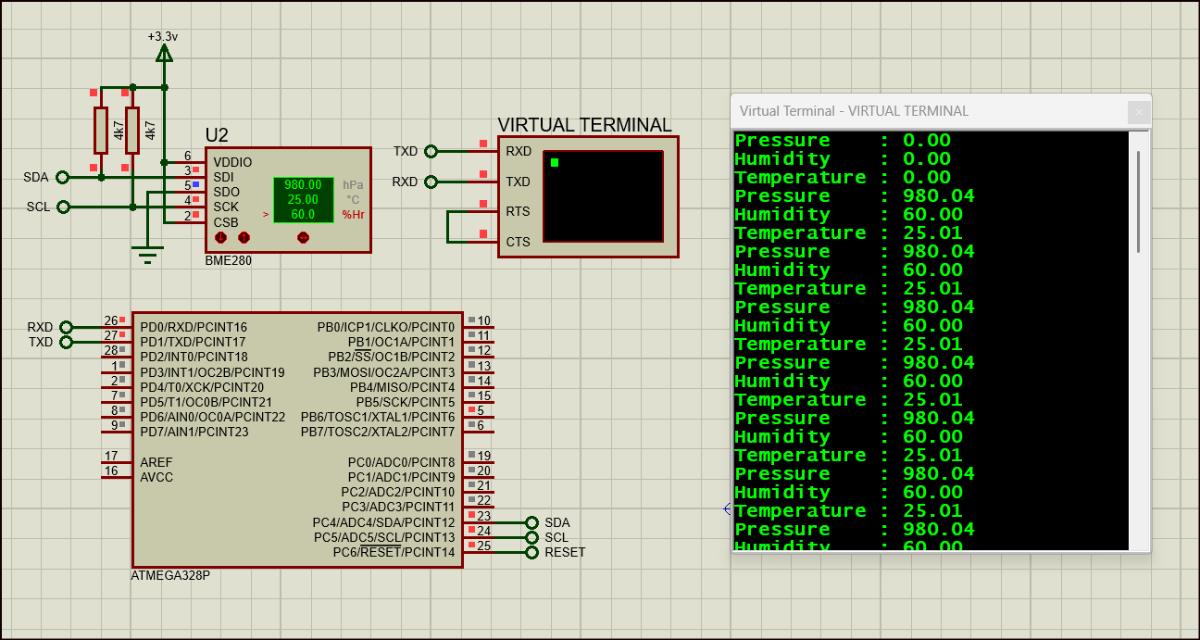

To get the BME280 sensor working correctly in Proteus simulation, connect the CSB pin to +3.3 V to enable I²C mode.
Also, make sure to connect the VDDIO pin to +3.3 V to provide the digital I/O supply voltage.
