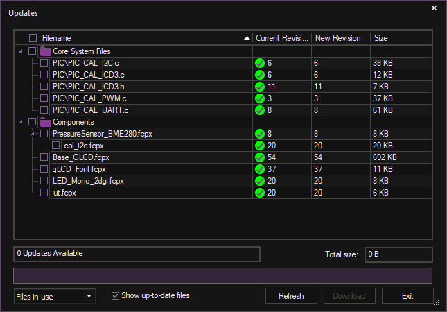

Can you please upload the "fcxlog.txt" file for this project as this may help us see why this project is failing to compile for you.
Also, here is a screenshot of the library files that are being used on my PC when I successfully compile your project:
Does your window (Help...Library Updates) show the same files and current versions?

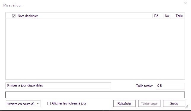

Re: Compile problem with FC11
No I don't have the same files
look at the attachment

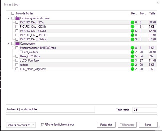

If you tick the box at the bottom "afficher les fichiers a jour" it should give a list of up to date files and you can compare there.
You would need to tick "Afficher les fichers a jour" to see the files that are up-to-date on your system. (edit: ninja'd by chipfryer27!)
But I think I have found the issue in the fcxlog file. It is showing that the PIC_CAL_IO.c and PIC_CAL_IO.h files may have been modified. I have attached the latest ones from Flowcode v11 and maybe you should replace your files with these (they will be in the "%PROGRAMDATA%\MatrixTSL\FlowcodeV11\CAL\PIC" folder).
If you replace these files, restart Flowcode and try again please.
Thanks Steve,
Now it is ok I compile correctly.
Really a thousand thanks again
- Capture d’écran 2026-02-27 181915.jpg (49.84 KiB) Viewed 4274 times
