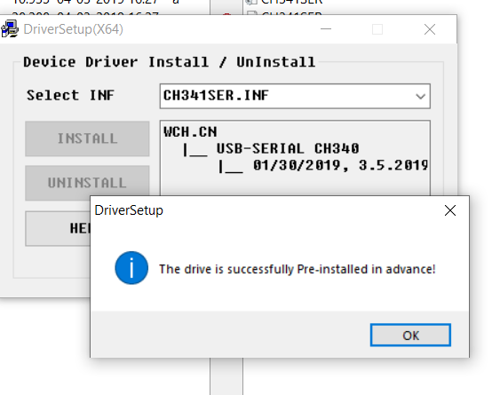

Hi Martin!
Thank´s for care.
I done your advice but still no USB port for ESP32
After install I reboot the PC.
Thank´s for care.
- Post.PNG (43.32 KiB) Viewed 9308 times

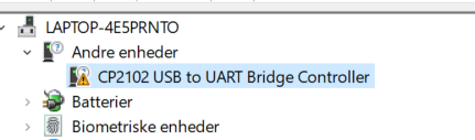

Little progres. After update windows I can now see this USB in device manager when I plug in the USB with ESP32. But there is no driver when I try to update driver? What did you do? please.
