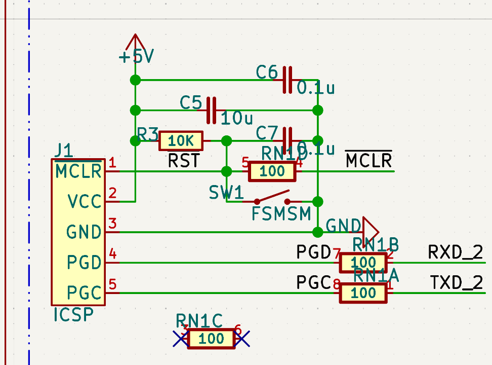

is your MCLR pin fixed to 5V or floating?
Another potential issue could be the programmer is not sending the correct configuration settings?
Can you read the microcontrollers memory including config settings and upload it within this topic.
You will need to zip up the file as hex extensions are not accepted.

The MCLR signal is pulled up to 5V and connected to the MCU via a 100-ohm resistor.
I am uploading the hexadecimal file, which was compiled in FC11 and read from the downloaded file.
Thank you for your interest.
2026-06-10 .png (106.53 KiB) Viewed 2317 times
