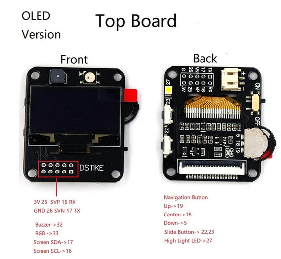

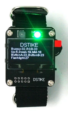

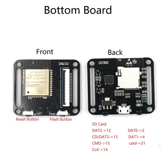

hello,
I mean this clock
DSTIKE ESP32 Watch DevKit oled
i think all chips from FC are supported or?
This product was planned at the same time of deauther wristband. I learned a lot of experience from deauther wristband and I knew ESP32 is a better choice for a "Watch".
The breakout pads are also designed to connect different sensors.
TX/RX could be used to communicate with computer or other control board.
17/16 is IIC port could be connected with RTC module or other IIC sensors.
SVP/SVN could input ADC signals.
25/26 could output DAC signals.
What makes it special?
Small size: 3.8x4.5cm
Height:1.5cm
Double 4 layer board
600mAh battery inside
On/OFF Power Switch
OLED version:1.3OLED SH1106(SDA-17,SCL-16)
Buzzer-32
WS2812b RGB LED-33
Navigation Button(Up-19,Center-18,Down-5)
OLED version external slide button(22,23)
Highlight LED(27)
Indicate charging LED(On means Charging,OFF means Full)
Reset and Flash Button at Bottom board
Breakout GPIOs(TX,RX,17,16,SVP,SVN,25,26,GND,3V)
SD Card support
GPIO12--DAT2
GPIO13--DAT3
GPIO15--CMD
GPIO14--CLK
GPIO2--DAT0
GPIO4--DAT1
GPIO21--card
Greetings SpeedPic32

Excellent that looks great, yes the chip will work fine with Flowcode and the display and other features should also work.I mean this clock

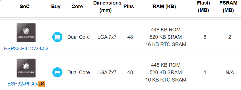

Hi Steve
Is it possible to support the ESP32 PICO D4?
Maybe later the ESP32 PICO V3 too?
For this ESP32 PICO D4:
There is currently no BLE profile supported in Flowcode 9,
Unfortunately, the standard configuration from Flowcode for all ESP32 Device is set to Bluetooth BLE.
The configuration must always be changed manually to Bluetooth SPP and if you are not careful it will be set back later during compilation from Bluetooth SPP back to Bluetooth BLE.
Wouldn't the standard for Bluetooth be better
BluetoothSPP (and without debugger messages)?
Could the baud rate for the ESP32 PICO D4 flashing instead of 115200 be 921600?
