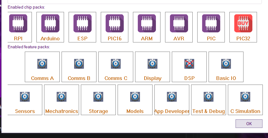

Do you have the sensors feature pack?

Hi Martin!
Yes I suppose it is this you mean
almost all pack. Look forward to test.

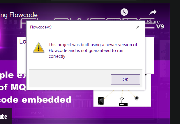

I just downloaded your examble from the helpmenu and now I get this message? I have updaded FC?
NO problen when I compile to hex.

Re: New MCP690X Thermocouple Component.
Ah yes.
VCs have the chance of testing an updated version before it's released to the public.
Ignore the warning as you should have no issues in running and compiling.
You still will have the latest public version which is V27 I believe.
