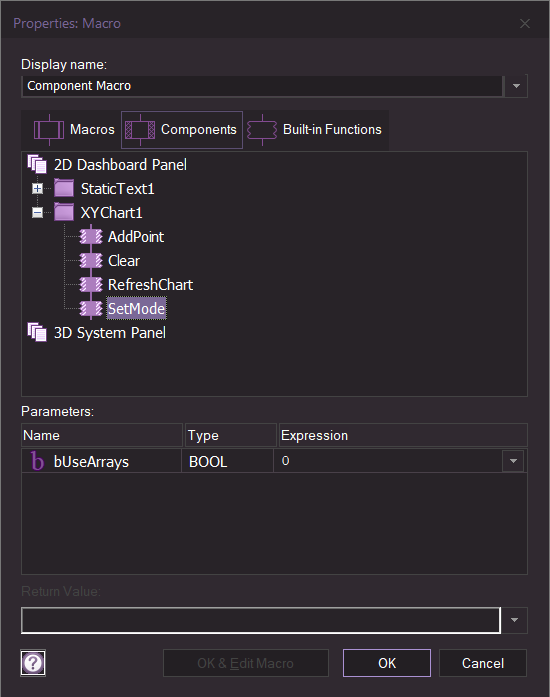

In my App I receive 512 values (16bit integer) via Bluetooth.
This I save in a buffer.
There is a SetMode command from the chart to choose using a buffer.
How can i use this hidden buffer ?
Is there a way to use integer instead of float in future?

stefan.erni wrote:
Mon Aug 02, 2021 5:02 pm
I can't quite remember, and can't check because I'm away from my PC. But I think the SetMode might not provide a benefit from v9.2, so I would not recommend using it.

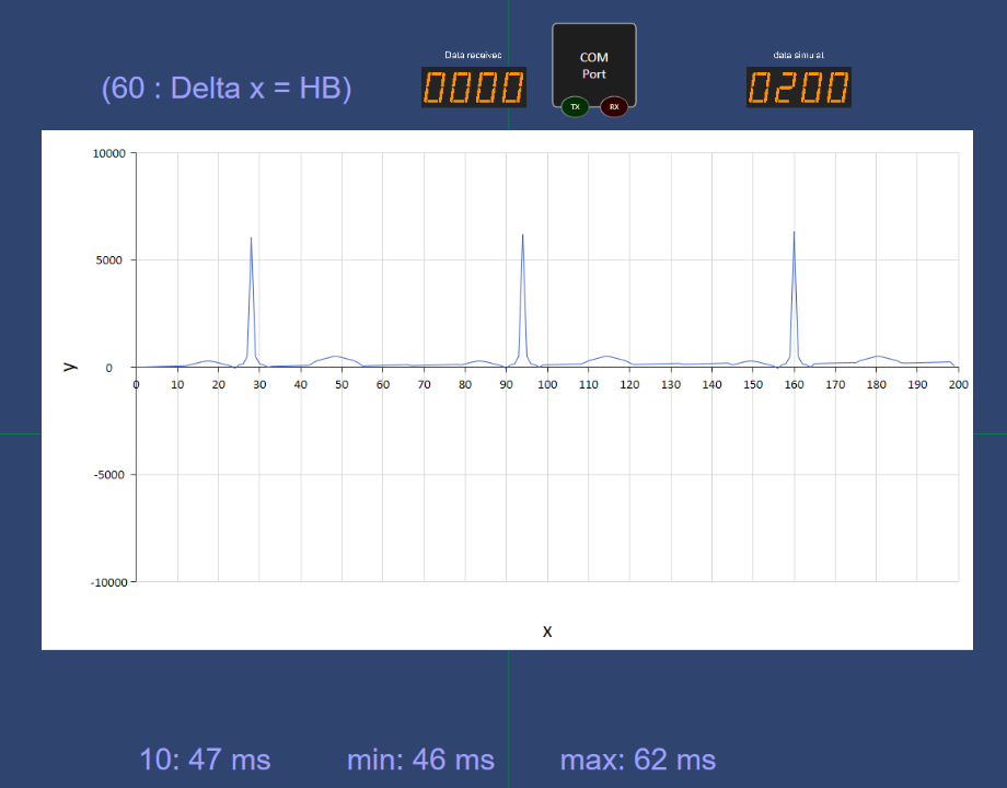

Hi Steve, Hi Janez
Yes it's working fine with float, even if I don't convert the integer before.
I add ECG simualation data to my test-app so you can see how it works without hardware.
I found out, that if the data is in the chart, you can manipulate the chart extremely fast. So rolling the chart works fine for me.
The App shows 10 times a signal and shows the min and max updatetime from the chart and it shows a scrolling chart. The App start and stop automatic.
in the zip are FC9 App and a deploit version
