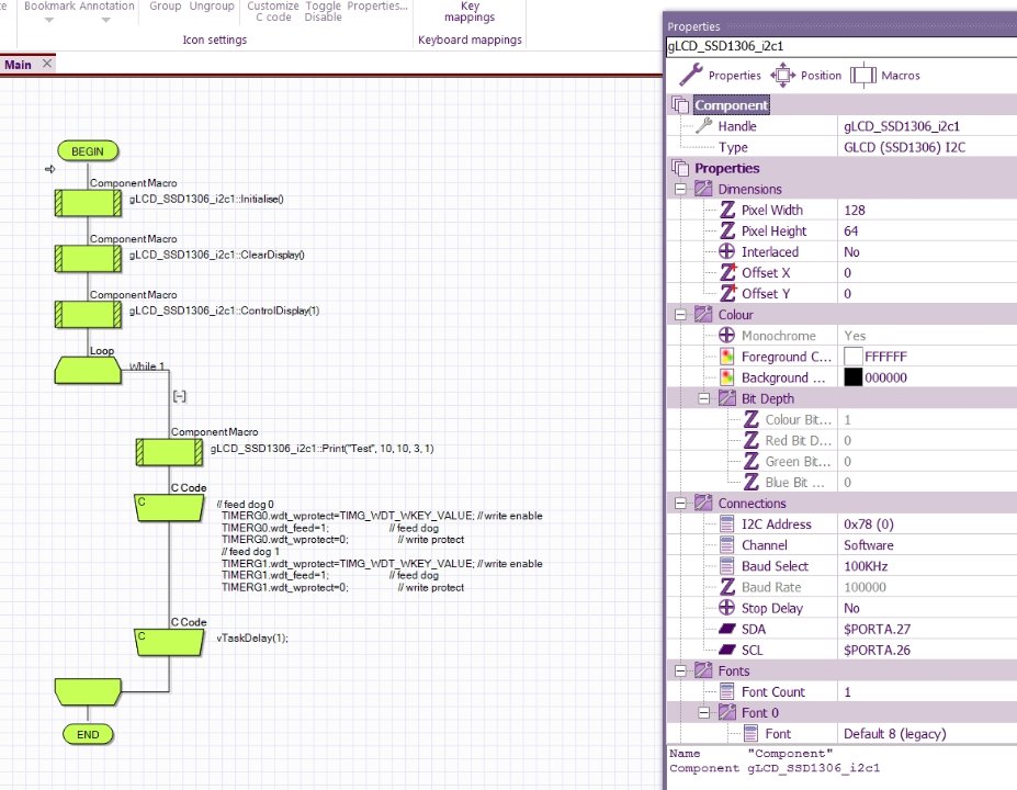

Re: OLED SSD1306 I2C Address
Hi Leigh,
The FC program looks like this at the moment:
This is how it's at this moment, I've been fondling with settings all the time.
Including changing stuff in the sdkconfig file.
Have a nice holiday!
(in my house it's now 22°C, outside it's 32°C so i'm staying in)
