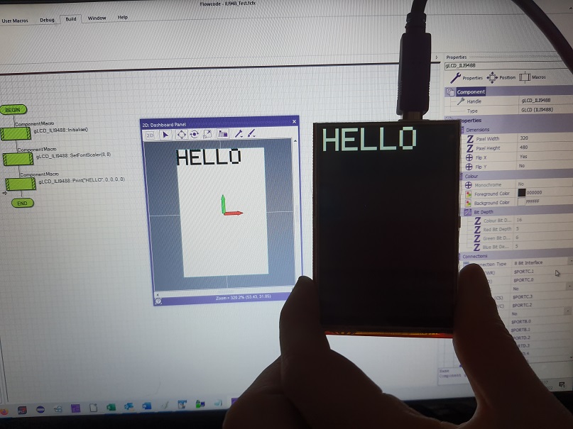

Hi Jorgen,
Sorry for the delay in getting back to you. I'll have a dig and see if I can lay my hands on a ili9488 display for you.
To save me reading back through the thread, did this specific display work in v8?
Do you have a link to the specific display you're using?
Edit: I've managed to dig out one of these so will have a go with it today for you. It's the parrallel version so the SPI version may differ.
https://www.ebay.co.uk/itm/123095177173
Posts: 2166
Has thanked: 590 times
Been thanked: 778 times
Re: Bug´s!
Seems to work though the colour inversion needs investigation.
I'll also compare the SPI version just in case there are any obvious differences.
Posts: 2166
Re: Bug´s!
Ok I've fixed the colour problem in the parrallel and SPI versions of the component using a new property to allow the colour to be inverted. Not only were the pixel states inverted but the red and blue channels were also reversed, hopefully this isn't just a quirk of my specific display. These display driver ICs have far too many options.
