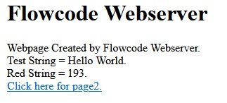

Basic read/write file functionality is now tested and working on the Pi.
I need to do more testing as well as folder traversal and also make sure it works with the libraries like the webserver but it's a great start and hopefully won't be much longer now until complete.
- Posts: 2242
- Has thanked: 616 times
- Been thanked: 815 times
Re: Unresponsive web pages
Well it seems to be working I've got basic read/write working and also allowed the webserver to connect to the file system and so far I think it's all ok.
There's probably a bit more polishing that could be done but for now there's a demo of the RPI webserver here.
viewtopic.php?p=8800#p8800
If anyone wants a simple demo for reading/writing files then let me know as I have one of these too.
