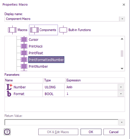

One more (last ) question. I see that the sensor should be able to deliver value from 1 - 65000 and it is so other do in Arduino IDE.
When I use a sharp ligth on the sensor the maximum value I kan get is 32000 the it look like it make a roll over an I get a -32000 has it something to do with the different setting in the macros no change if I use value Integer or Long or Ulong, float ect.? pls.
Jorgen.
Posts: 2309
Has thanked: 718 times
Been thanked: 778 times
Re: BH1750FVI Ambient Light Sensor
Woops, Sorry.
I should have changed PrintNumber to:
The variable should remain as UInt = 0 to 65535
jgu1
Posts: 929
Location: Denmark
Has thanked: 839 times
Been thanked: 205 times
Post by jgu1 »
No sorry. Work perfekt :D :D
