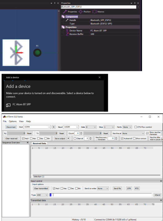

It's working again with the M5 Atom board.
But I don't know why.
I guess, because every time I rename the program or copy it to another folder I have to redefine the two lines in the sdkconfig file.
On this occasion I would like to mention the simple drag and drop of Flowcode for ESP32 Bluetooth. You don't need a pin or baud rate and you never confuse about rx and tx pin. And simple to choose a Bt name. Also to check if it's connected is so easy.

- FC9_M5STACK_Modul_Atom_BT.fcfx
- (9.25 KiB) Downloaded 1074 times
- (view online)
- BT-ok.png (97.92 KiB) Viewed 16792 times
