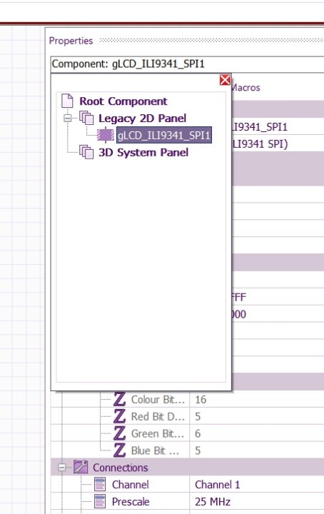

Tried to get into the SPI settings of the component, but there doesn't seem to be an SPI component behind the ILI9341 component?
Or I just cannot find where to find it.
Have you ticked the show full component tree tickbox in the component debugger window?
I've pushed some more changes to the update system that should hopefully allow things to work correctly again.
Let me know how you get on.
