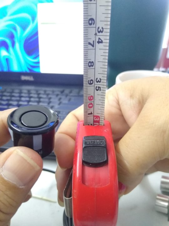

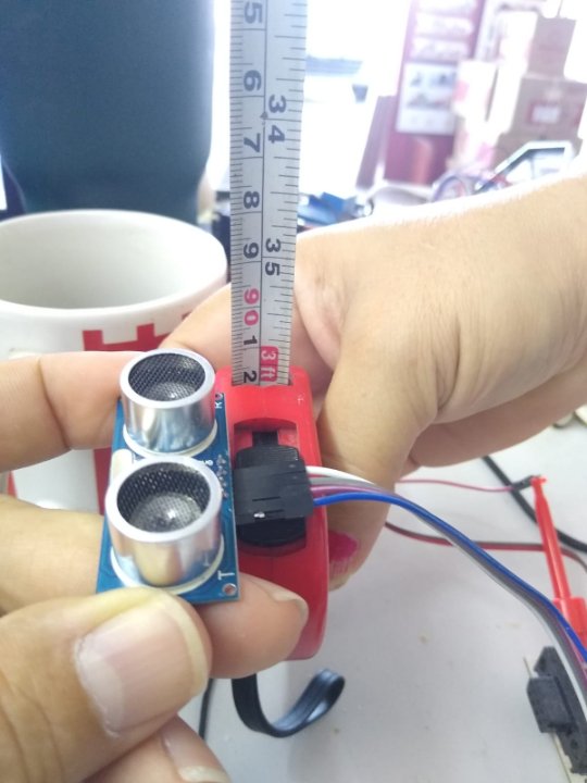

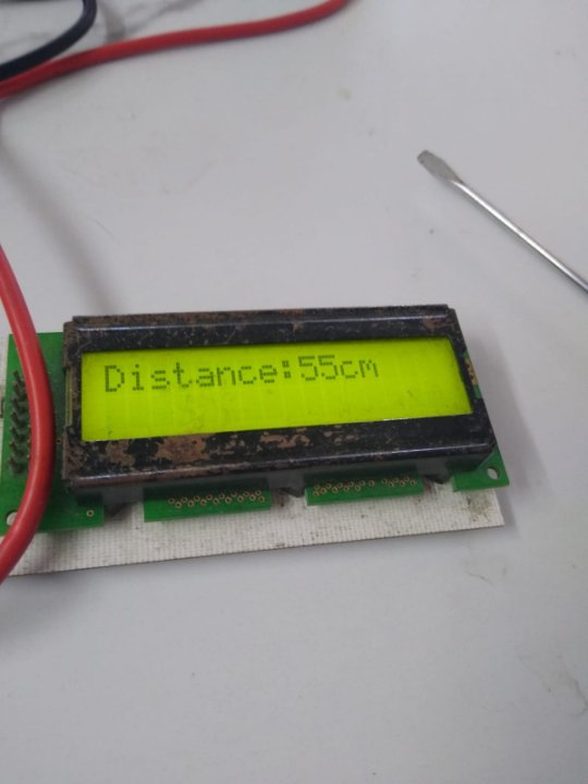

An apology Martin, yesterday I was not able to do the tests, now I downloaded the component and saved it in Flowcode10, components, HC_SR04_Ultrasonic.fcpx, I opened Flowcode 10 and the program, and did the tests with both sensors, but they gave me the same data ( not correct) use a PIC16F887.
I will send you a photograph of the reading and the real distance.
Best Regards
Enrique
Best Regards
Enrique
- physically measured HC-SR04 WATERPROOF
- Sensor clasic.jpg (51.95 KiB) Viewed 6858 times
- Reading of 2 sensores same distance
- Lectura.jpg (33.94 KiB) Viewed 6858 times

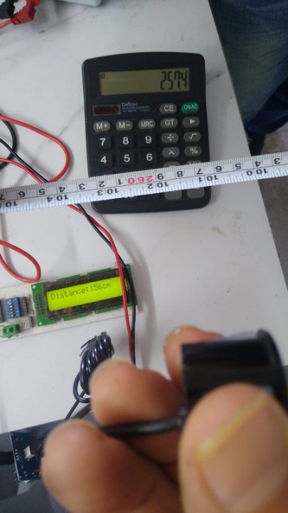

I hope this information helps in some way; The program to download the new HC-SR04 component has just finished, the sensor did not work in port C, but in port B it did work, but it delivered the same erroneous data; but if you multiply the reading delivered by the sensor by 1.65 it approaches the correct distance 55x1.65=90.75 (correct distance 90 cm) with an acurrence of 1 cm. The other reading was 30 cm; 30x1.65=49.5 (correct distance 50 cm) another reading further away is 156 cm; 156x1.65=257.4 (correct distance 257) I send a photograph of the data taken.
Theoretically you would lengthen the measurement distance more.
What opinion do you have or what could be the solution
Enrique
Enrique
