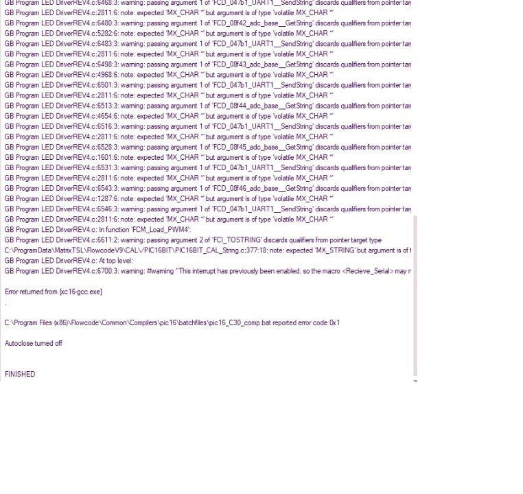

I did download the new stuff, but now my program will not compile to hex. Am I supposed to do anything besides the download?
I have just been compiling before I downloaded and had no issues.
No compile.jpg (117.05 KiB) Viewed 5657 times

Hi Alan,
Please post your "*.msg.txt" file as the screenshot shows only the warnings.

Sorry about that Alan,
I replicated the problem here and have now hopefully fixed it for you.

Ben -
My analog stuff works. Thank you very much for working this for me. I know how tough it can be developing a new product, and I'm very appreciative of your efforts to help me.
