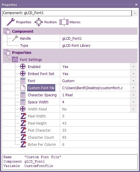

Right I've not had time to test this in action but it looks to be working and should allow you to point Flowcode at the dot factory .c file output directly.
First go to library updates and get the latest Font component, then restart Flowcode.
Next in your display properties set the font to custom, it should be right at the bottom of the list.

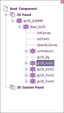

Finally go to View and Component Debugger and then enable Expose Full Component tree.
In the drop down at the top of the properties window select the Font component inside the GLCD_BASE that has the custom font selected.
Change the Custom Font File property to point to the unedited dot factory .c file.
Fingers crossed that should all work and this should both simulate and download to target.
If this works ok for you then I'll roll out the new custom file property to all the displays so you don't have to use the full tree view.
