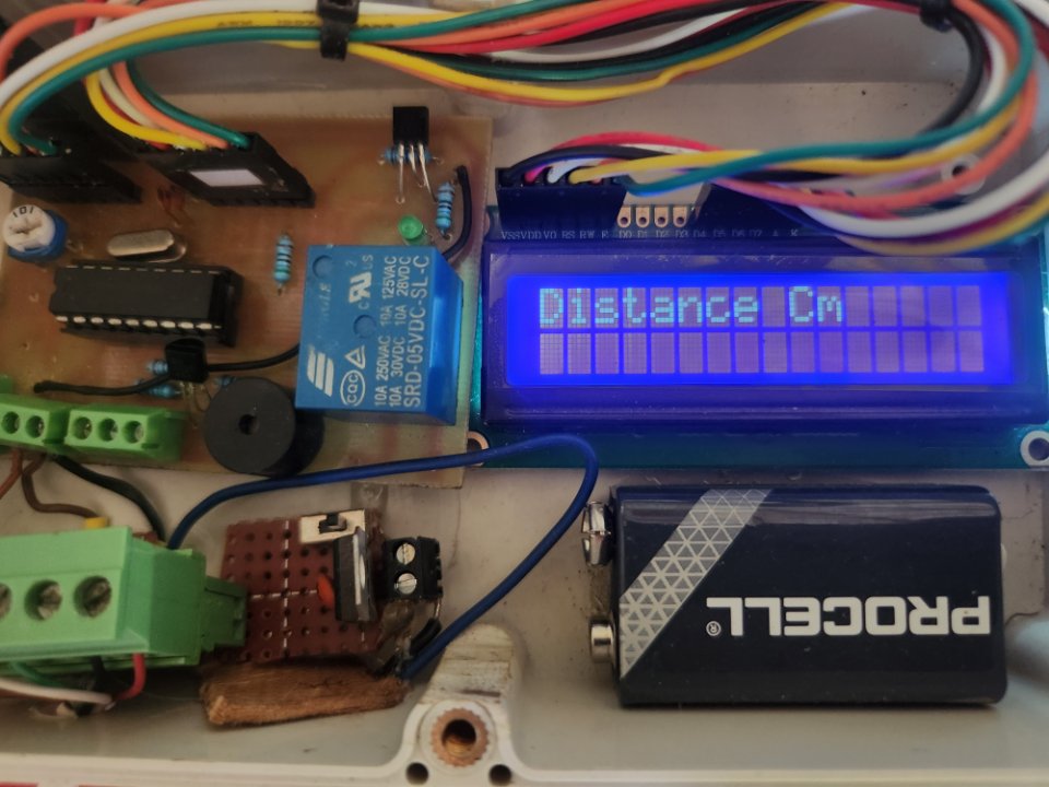

Re: HC-SR04 Working BUT NO VALUE
Hi, Martin
Seems something has gone wrong again with the component. ""AM NOT SURE""
No changes were made to my program. I am not seeing the values again.
It's strange cause I was using it Half an hour ago and it was showing its value.
BUT NOT ANYMORE.
>>I DIDNT DO ANY UPDATES
I have an OLD v5 Project that I made 2 years ago. works very GOOD. I used it to confirm IF My Project AND Circuit Still Works
It was Ok.
I have 2 images I attached one v5 and v10. IN the meantime, can anyone Esle confirm and tell me if there seeing Value's on their LCD SCREEN?
Please and Thanks to everyone
BUT NOT ANYMORE.
It was Ok.

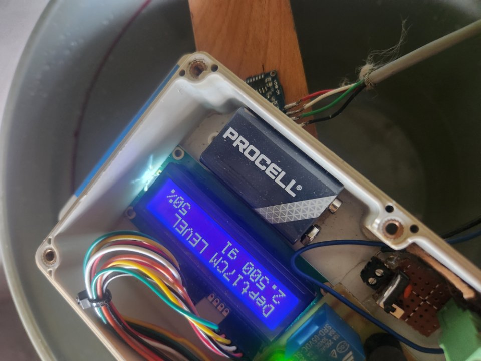

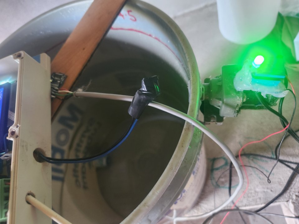

Re: HC-SR04 not working with ""Pic"" Anymore
Martin,Br Jorgen
YES, I Change the TIMER INTERRUPT to YES/NO
Long Before the Summer it was working "PERFECTLY FINE" (v10) During that time When I just started using it with v10. I did some test and found out that when timer Interrupt it Disabled it Didn't work WITH "PIC" But WORKS BETTER WITH ARDUINO. So, what I did in v10 is Mimic the Inputs and outputs from v5.. an i got it WORKING in v10 BEFORE SUMMER.
I used the v5 Project to do 2 Different Project. In the image above that's one of them. I used the other to Do a crucial Project Detect when water level rises.
However, I want them to be on the Phone. I then upgraded to v10. So, I could be able to visual things on the phone. (HAVENT REACH THERE YET)
Now I got some time on my hand am ready to recreate it in v10. (So, when I ready to test it back the other day that's how I found out something is wrong with the component, "WE HAD ADDRESS IT" the other day. and it works.
up till this morning it works. All of a sudden there no value.
I evening change the ultrasonic Sensor just to see if it was it. Then I Revert back to v5 that's in the First image above. it works.
>> I have copy and relace the file inside the folder again.
>> Restart the Laptop
>> shut it down
>> I revert Back again to v5. to confirm if (Project/Circuit)
>> Print number wasn't disabled
>> I went back for the file that I posted on this topic. Still no work.
THIS IS VERY STRANGE
I find it Very odd.
Image of v5 Project just uploaded just now.
>> the external led outside indicates that the Inlet valve is Open.
THE ONLY THING THAT LEFT TO DO IS JUST TO UPGRADE THAT V5 PROJECT TO V10 AND SEE WHATS HAPPENING.

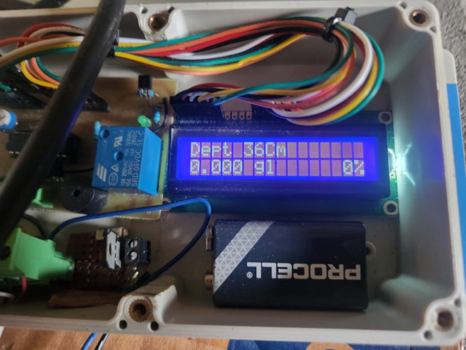

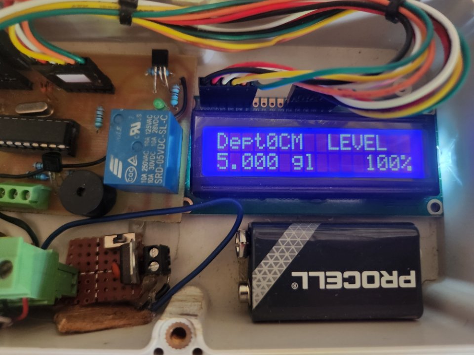

@ martin Yes, I did Check. and IT compiled, evening thou it's not showing any "VALUE"
HOWEVER, THE AUGUST FILE WAS SHOWING "VALUES" YESTERDAY MORNING. Until half an hour after that STOPPED
So basically, I cannot Create a "NEWLY PROJECT".
>>HAS ANYONE ENCOUNTERED ANY PROBLEMS LIKE THIS?
>>WHATS THE SOLUTION?
I Open a new project and decide to create over the project. (may be file can be corrupted that's why it's not showing any values).
When I create the new project with the "LCD ONLY" it didn't work "EITHER".
I had some email to respond to this morning, Somehow, I went in my Draft and found that I had save that same Project in "MARCH" there.
When I downloaded the MARCH one and test it... IT WORKING (v10)
BUT THE August, one Don't Work
I was planning on doing some test with different "uC" to see if the values are showing up.
But like how the MARCH one is working I will go ahead and finish it up.
Here's an image of the March one below.
