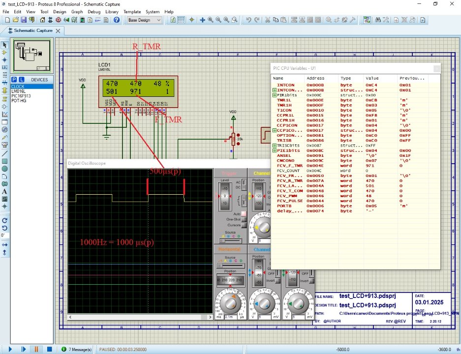

Hi Martin! With my code the results look disgusting. 650 "ticks" TMR0 is for Proteus. It works slowly compared to real hardware. 6500 for hardware. I assumed that TMR1H = 236; TMR1L = 120; will make a tick of 1 ms Timer 1 when 20 MHz quartz. This is what the PIC calculator gave. Thanks for the recommendations. I will try to understand and fix everything. Best regards, Peter

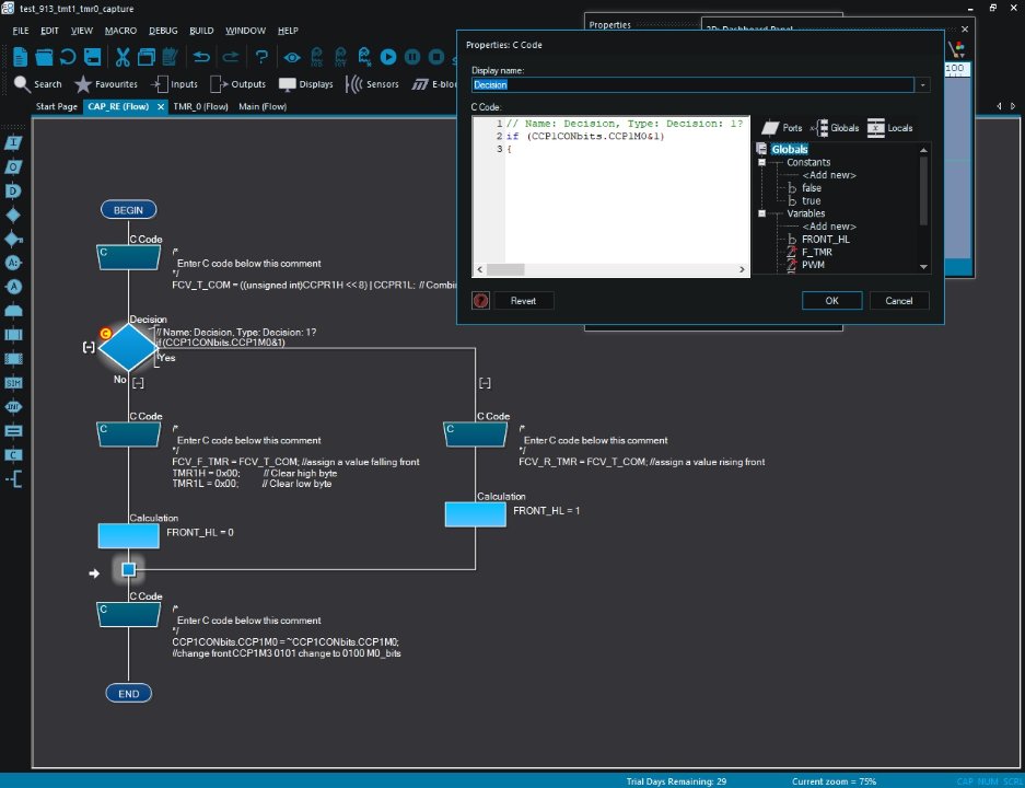

Happy New Year! It looks like I got what I wanted. But there is one big problem. If you look at my example lowcode implementation of capture you will see that I blocked the TMR0 component because it affects the CCP interrupts. However, I need TMR0 in the main program. How to get rid of the influence of TMR0?
Best regards Peter

I don't have access to a computer until later - but I notice in CAP_RE you have if(0) which will never be true. Was this intended?

Flowcode understands this as reading bit M0 in the register of the CCP1CON

Re: PWM + Сapture + Сomparison
Post by carworker »
Again my inattention. I understood what you were talking about and found the error. if (PIR1bits.CCP1IF); is nothing. It should be if(PIR1 & (1 << CCP1IF));//CCP1 interrupt capture event occurred if flag CCP1IF=1 in PIR1. You wrote about this. Now TMR0 is in action. Thank you.
Yes - I see. I'd used the online FC viewer (thanks to Ben - it's often a great help) on my phone - and it just decoded it as if(0)...
Glad it's all coming together...
I think the issue is just the ';' at then end of the line...
so if(true) ; - will do nothing it needs:
if(true) {
   stuff to do if true;
The semi colon just gives an empty expression...
This is still wrong in the last upload:
if (PIR1bits.CCP1IF)  //  ';' is wrong here !
FCM_%n(); //read int in body
PIR1bits.CCP1IF = 0;  // Clear interrupt flag
Then should work correctly.. Note that on an interrupt (with the semicolon) - this would check if CCP1IF was set and do nothing if it was (;) then the following code would always be executed which would always call CP_RE(), and clear CCP1IF
