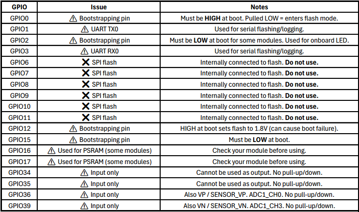

Yes there is.
If you run Library updates and change Files in use to full database, the latest ADC CAL should resolve your issues.
You should now be able to used ADC2 instead of being restricted to ADC1.
You will still need be wary of sone pins:
Pins used with caution.png (157.79 KiB) Viewed 6914 times
