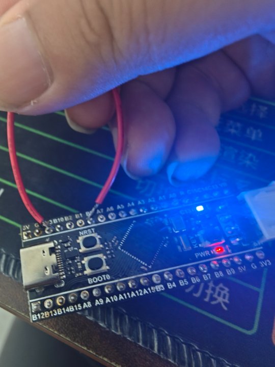

LeighM wrote: ↑
Wed Jun 18, 2025 3:28 pm
Step at a time...
Have you tried the demo on hardware?
It gives a short LED flash every half second.
Gives a long (half second) flash of the LED when the interrupt input is triggered.
What do you see?
Yes, I have tried different STM32F411 Boards. now it works, thank you very much!
Best regards,
Deqiang

Hello Steve,
Thank you for your test projects. It also works on my computer.
Then I open the earlier projects I made, when I open and directly run, it not working, then I open the interrupt macro and re-select the same EXTI pin and re-save. The program works. The update library Should be working.
Thank you and your colleague(Martin), solving this is important for me to carry on my project.
