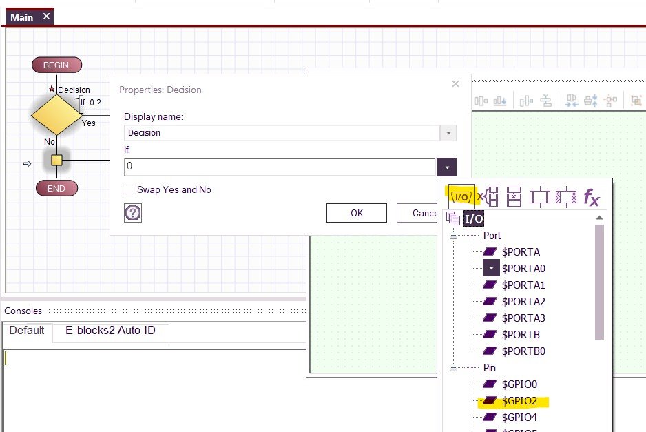

Maybe not quite what you are after but you can reference pins directly, for example in a decision
Screenshot 2026-02-12 214622.jpg (87.23 KiB) Viewed 3081 times

Possibly!
I suspect you might be able to do $PORTA0 = 1 in a calculation too?
Though - this is new to me - and I've not tried it...

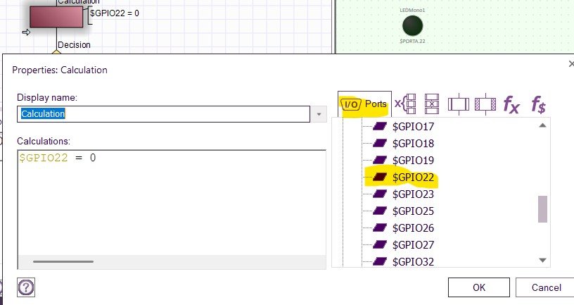

You can indeed reference ports/pins in calculations.
This calculation immediately turns on the inbuilt LED on a lolin-lite (pin 22, active low)
Screenshot 2026-02-13 051633.jpg (48.19 KiB) Viewed 3053 times
