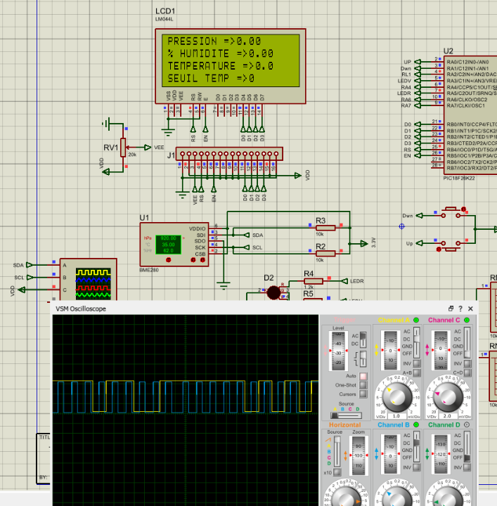

Take a look at the copy of my schematic; it's wired exactly as you described, Bijumon (Thanks for your feedback)
Martin, you're right—I just measured the values on the SDA line with the oscilloscope and got a peak signal of around 5V, whereas on the SCL line, the peak signal is only 200mV.

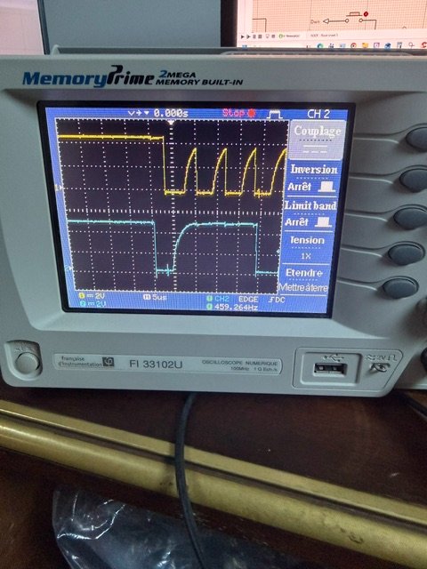

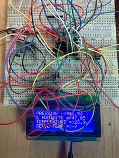

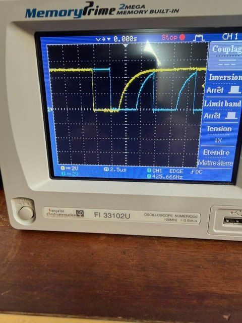

I’m getting back to you with some thoughts regarding the malfunction with the PCB.
In Flowcode, I did correctly configure the unused pins as inputs with an initial value of 0. However, on the PCB, I didn't physically set these pins to a pull-down state!
From experience, I know that the 18F series is very sensitive to this kind of oversight. I rushed the creation of this prototype PCB—I really messed up!
I’ve attached a few images. The readings from the PCB were unstable, whereas the ones from the breadboard are perfectly stable. My next step is to desolder the BME from the PCB and test it on the breadboard.
A huge thank you to everyone, and especially to Martin, who helped restore my confidence and got me up to speed with this BME sensor. Just for your information, Martin: I am indeed getting a return value of 1 during the BME initialization.
Luc
