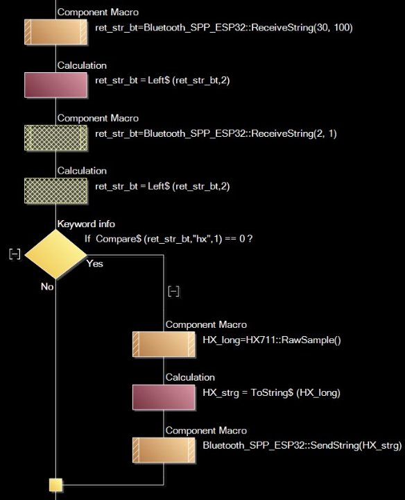

Receiving long string is working also if the receiving command and string is long enough.
But if the command is dimensioned too short, it can crash an it's need a hardware reset.
