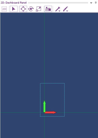

I lost it again. In library of components it is shown but I can not add it on 2D dashboard. What happen with it?
It is non visible.

It probably doesn't show as anything - and it certainly won't work in simulation...
It was a long time ago and I didn't know how to do it then... One day I might try (or maybe a volunteer out there would like to add the 'missing' bits????)

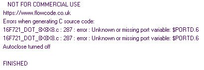

Yes, I try with other MCU but there is an error. But this MCU do not have port D. I can not understand it. You can see below attachement.

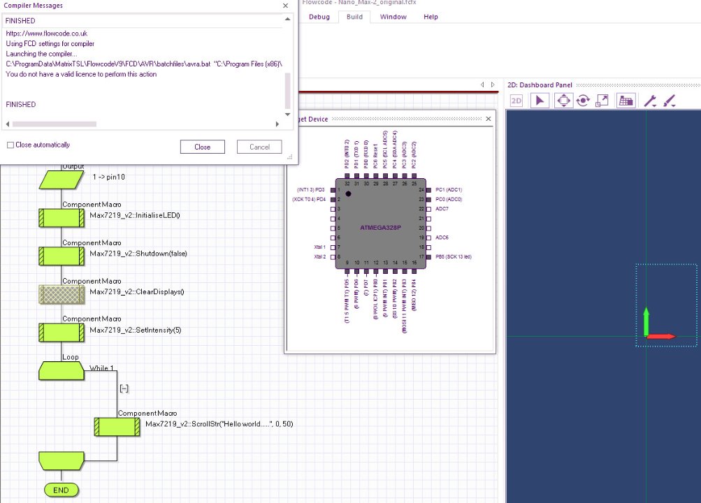

With Arduino Nano 328P it is so:

I think the problem is that the Nano is not one of the free targets. Arduino Uno is..
When I wrote the component I couldn't work out how to have an unconnected pin - and I think one 'pin' was hidden and that meant that the code is tied to AVR...
Things have moved on - and it should be easy enough to either 'tweak' the component to remove the pin or even just to move it to the top level to allow the user to reassign it..
I'm at work this morning - will have a look this afternoon.
