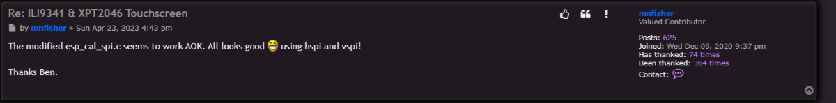

Have you seen mfishers answer I highjacked the history with my issues. I will test later.
