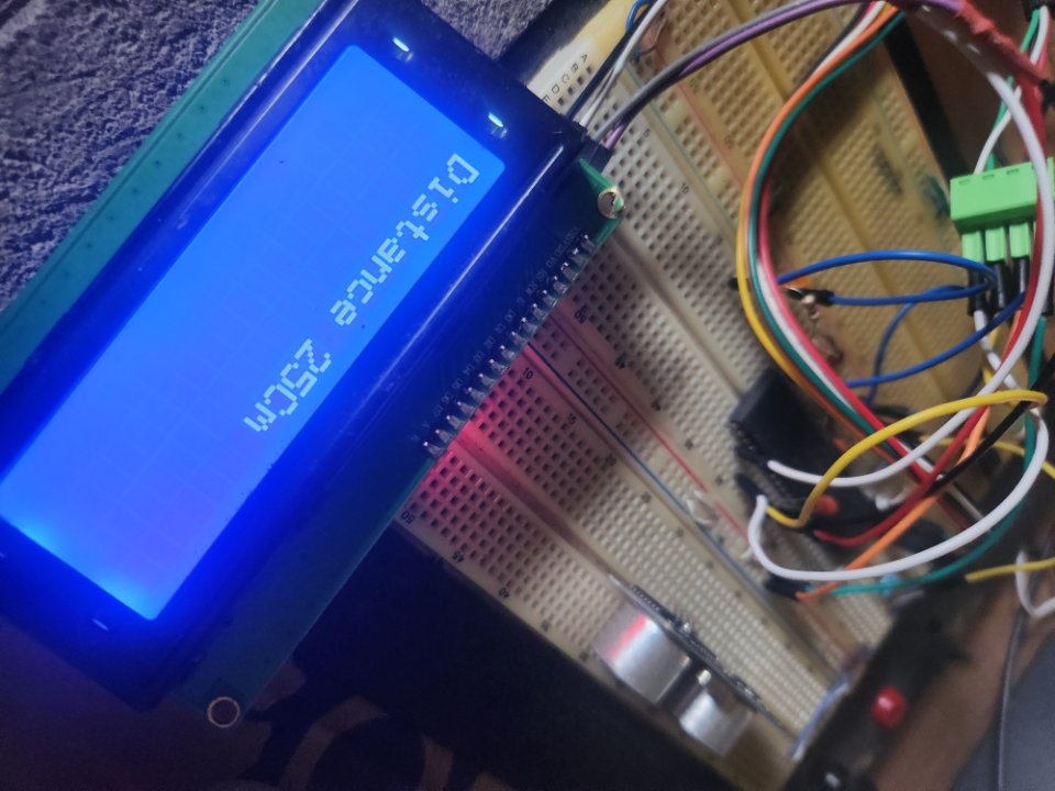

I simulated the OLD Project with the "MAP FUNCTION" and it work using the Pic16F877A.
I had an old example with the Map function using PWM as well and it responded too
Just confirm to I created a NEW Project with the HC-SR04, and Pic16f877a It work, showing its value, IMPRESSIVE READINGs
>> Still not showing values with the smaller uC "Pic18f1320" anymore Not sure why thou.
>> also trying using the "Map function" with the new project I just created. Map function Didn't response.

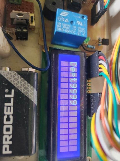

Re: HC-SR04 Return 9999
Can anyone check and tell me if the Sr04 components Is Working?
Mine is returning 9999 Now.
