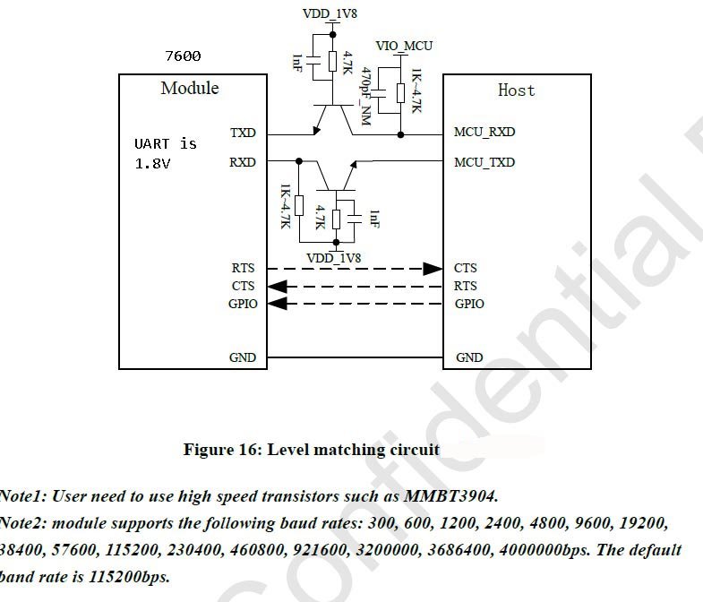

Hi Viktor
Thanks for the diagram. The modules I'm using have a 5v supply with 3.3v Tx / Rx pins. I use a USB-TTL adapter that is switchable between 5v and 3.3v and this was checked to be functional.
My first 7600 module had an issue on its Tx pin, but would accept commands sent to it.
My 7670 works fine with the adapter
Replacement 7600 appears to have Tx/Rx pin issues too, but I've not investigated further.
As mentioned, as it appears to have v1.xx AT commands, I'm guessing these are old stock and may have solder issues due to aging.
It's worth double checking everything including pin voltages, and I'll do that when I next get a chance.
