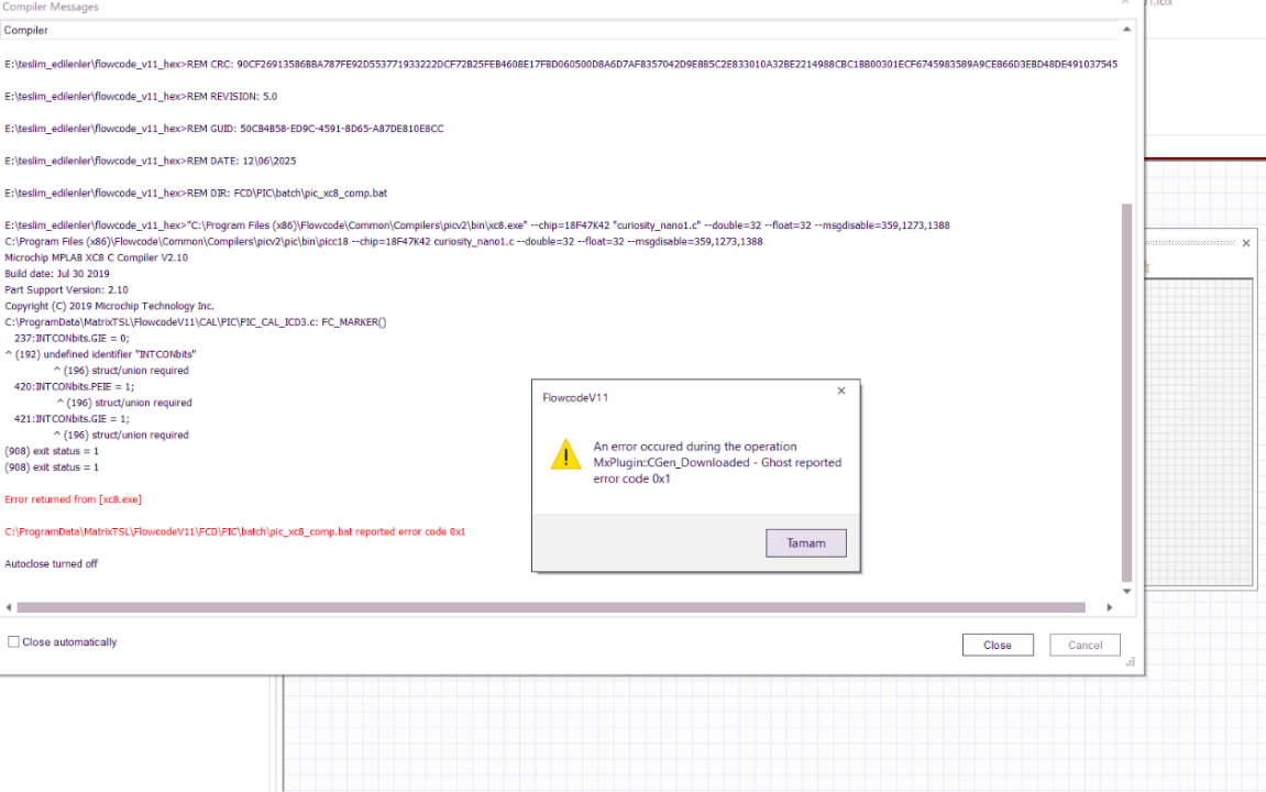

Hello. As you described, I placed the program you sent into %ProgramData%\MatrixTSL\FlowcodeV11\FCD\PIC\. However, this warning message appeared on the screen.
- v30.png (268.92 KiB) Viewed 109 times
- Posts: 2469
- Has thanked: 793 times
- Been thanked: 851 times
Re: Curiosity Nano pic18f47k42 does not work .
At least now you can compile OK.

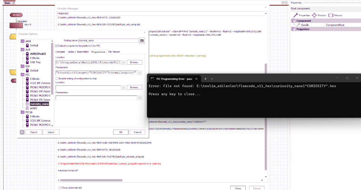

The `compiler+programmer+location` line is working. However, I would appreciate it if you could explain the expression "$(outdir)$(target)"CURIOSITY"$(compilerpico)" in the parameters line.
- v31.png (225.9 KiB) Viewed 95 times
- Posts: 2332
- Has thanked: 647 times
- Been thanked: 856 times
it looks like you have not copied the programmer parameters line correctly.
You have
But it should instead be
The spaces separate the fields to the programmer script, the first is the project directory, the second is the project file name, the third is the drive name, I believe the fourth is not used I just copied it from the pico programming script.
If you check the E-Blocks as default then it should override from the definition file and work as intended without you having to manually put the text in.
You have
"$(outdir)$(target)"CURIOSITY"$(compilerpico)"Code: Select all
"$(outdir)" "$(target)" CURIOSITY "$(compilerpico)" If you check the E-Blocks as default then it should override from the definition file and work as intended without you having to manually put the text in.

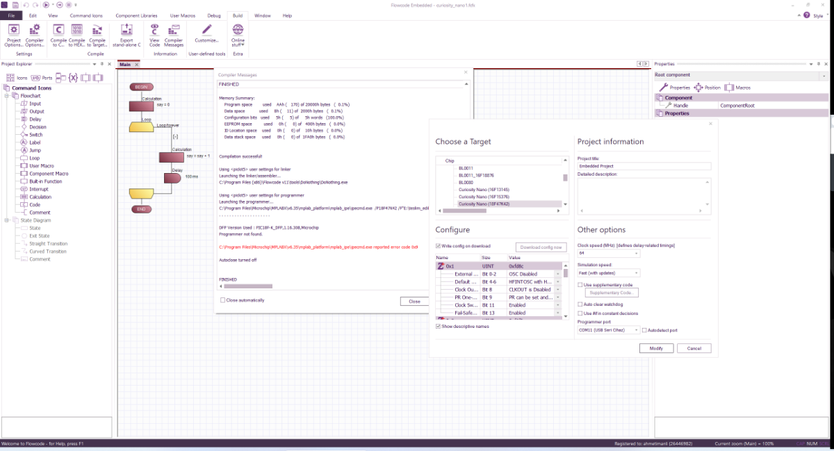

Thank you very much... I installed the program and it worked. I can't read or modify online data with debug and ICD. Could you help me with this as well? I'm installing the program with compile to target.
I'm trying to install it again with debug enable ICD, but it's giving an error.
- v32.png (238.51 KiB) Viewed 80 times

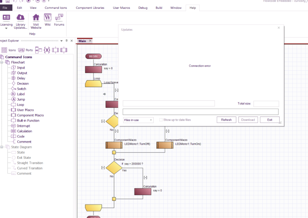

When I try to update the library, I get a "connection not found" error.
- v40.png (219.01 KiB) Viewed 57 times
- v41.png (204.29 KiB) Viewed 57 times
- Posts: 2332
I'm working on the ICD debugging, I got pretty far but ran into a problem specific to the curiosity boards that we are looking into.
As for the library updates I've just tried it here and it's working for me, where are you based? Can you access the Flowcode website ok?

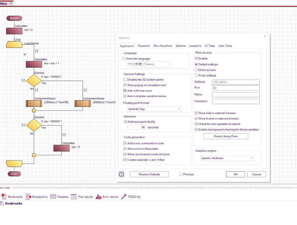

ahmetimanli
- Posts: 26
- Joined: Mon Sep 02, 2024 11:41 pm
I can easily access your site using Google Chrome. I can also access it directly via the link sent to my email address.
