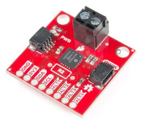

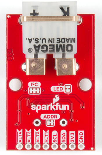

I use the sparkfun MCP9600 screw terminal board and an ESP32.
If I use I2C Softwaremode I can read the temp from the sensor correct.
but the K element gives me also some value but in the wrong direction
when I increase the temperature, the MCP9600 measures less.
In ic2 channel1 mode, it's not working. Always get 1931 as value.
I am still doing something wrong?

I was able to solve one problem.

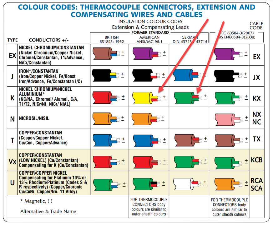

Until now, I always thought of the colour red as positive voltage and the colour yellow as ground, but not with the K-elements
The incorrect values are due to the different colours of the sensors wire. Red is not always the positive pin and yellow the negative.
So I have turned the sensor wires and the temperature is now measured in the correct direction.

a short description of my project:

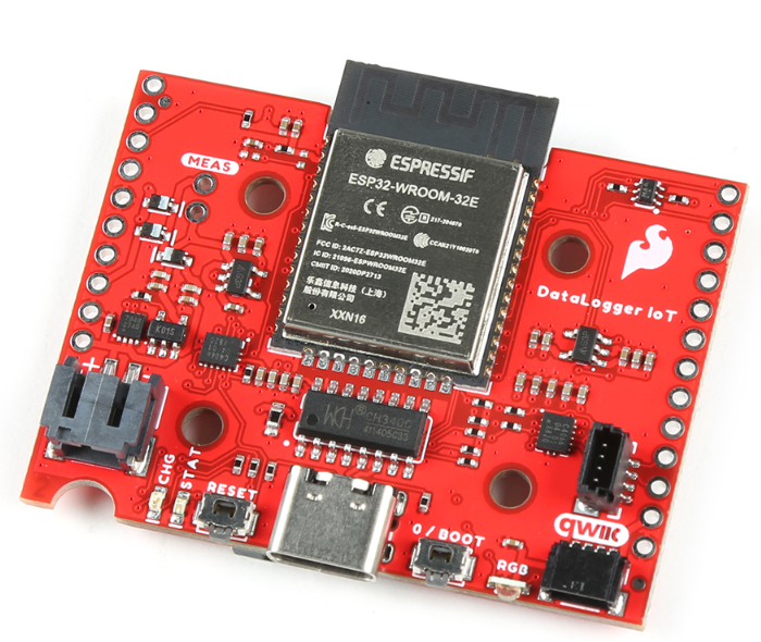

My Board with a ESP32 and sd-card 4wire:
a few sensors
I have not yet decided whether I will use it for screwing or plugging
screw:
plug:

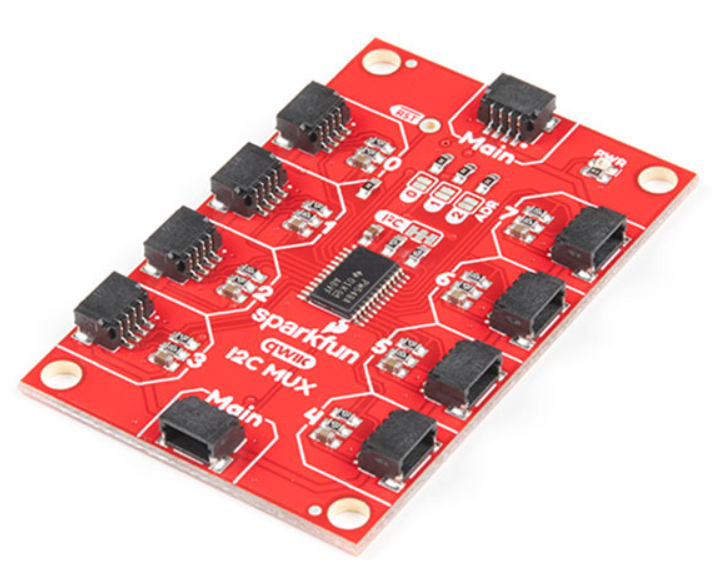

i have not decided yet if i will change the board with the addresses or use a multiplexer

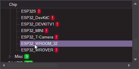

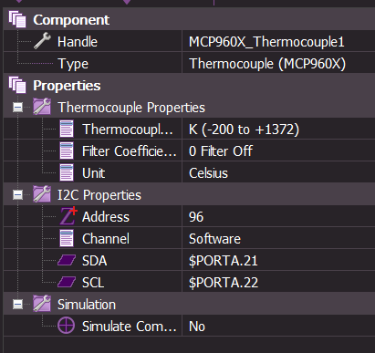

I have just tested my MCP9600 on CH1 on Wroom-32 and is working as expected.
What pins are you using for data and clock?
Posts: 1305
Has thanked: 246 times
Been thanked: 258 times
Re: New MCP690X Thermocouple Component.
Hi Martin
on the Wroom_32
SDA A21
SCL A22
I used channel 1
Posts: 2494
Has thanked: 800 times
Been thanked: 866 times
Thanks Stefan.
I have tried with CH1 on the Wroom-32 and with the same pins as you and it's working for me.

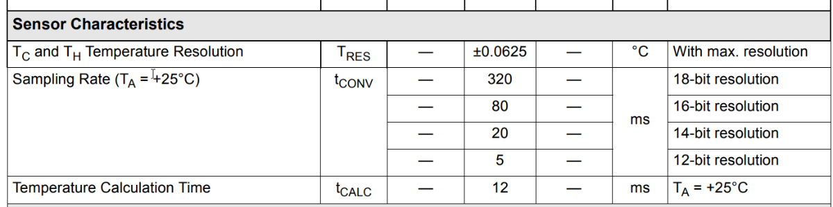

During this time I measure with 10hz and expect a temperature of 20 degrees up to 50 degrees. I want to measure with a resolution of 0.1 degree
it's working at the moment. But there is still a small problem.

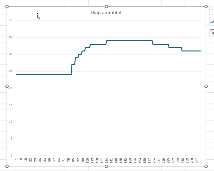

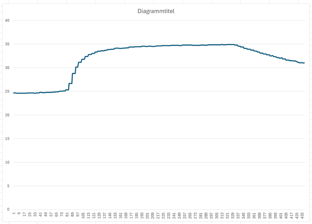

I do a simple test and touch the sensor
When I read out the 16 bit integer I get a resolution of 1 degree celsius. This is not useful.
If I read float I get much more accurate values. I use 10Hz samplerate
but even with float there are large jumps and the values remain the same during some measurements.
This MPC9600 has many settings. How can I adjust these or know what they are set to?
Samplerate and resolution:
read 16bit:
read Float:
