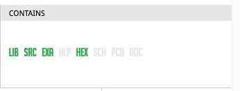

S_V
Re: MCP3561/2/4 MCP3564 Click Board
Hi Peter,
Very True, MikroE libraries are "closed source" most of the time.
but if the SRC under "file CONTAINS'" is highlighted in green, then there is a good chance of source code in the zip file.
- Screenshot Lib.jpg (8.62 KiB) Viewed 22052 times
