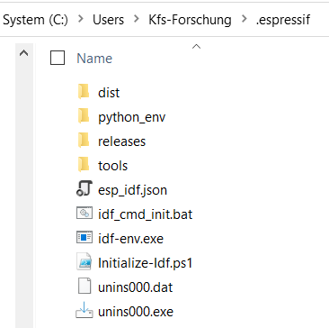

Just from my experience when I created the esp-idf folder it automatically creates another folder espressif and puts the file in that when I forced it to install in the esp-idf without the espressif folder everything worked.

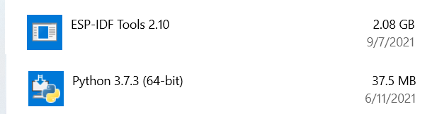

@ Leigh Here is the version of Python and ESP-IF Tools on computer 1 (the one where works well) I will see what version are on the other computer and check if there are more than one version of Python.
@Jollybv You mean for the second folder (.expressif) you choosed the same folder (on Desktop esp-if). I will try that.

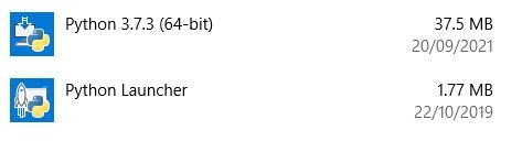

Hi Leigh
There is the same Phyton but there is a Phython Launcher on the bad computer
