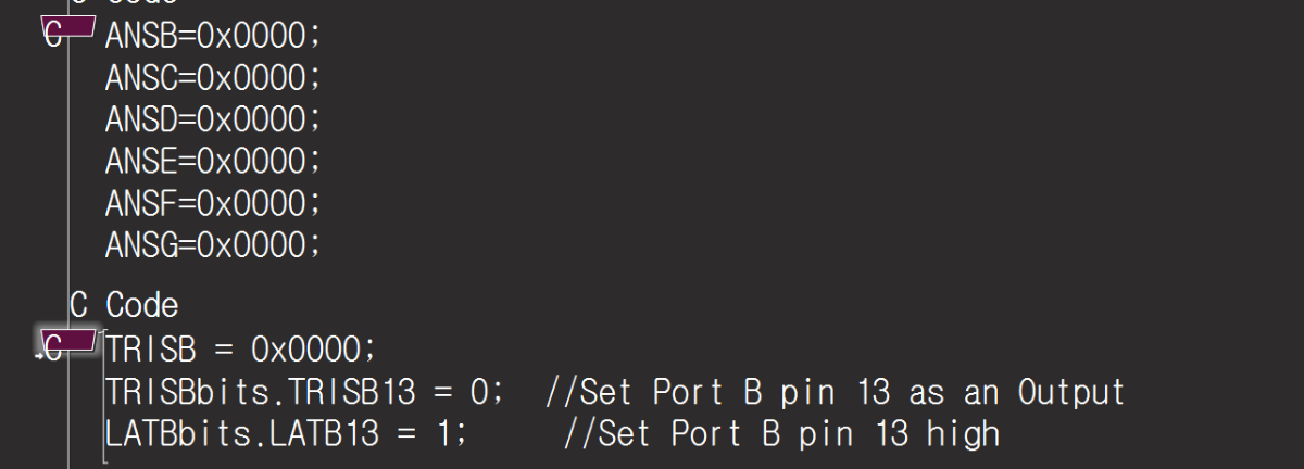

I want to output to RB13. But it doesn't work.
More advice please.

Pin B13 is a JTAG pin, do you have JTAG debugging enabled in your configuration settings?

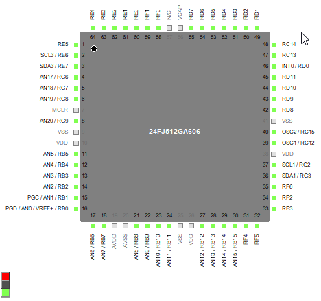

However, the interrupt does not proceed.
And how do I set the IOC Port?
What is the meaning of red black green in the picture?
How do I set it up?
Thank you for your help as always.

If you change to the light theme it will show you: Not all microcontrollers allow you to have control on both rising and falling edges.
To change the state of each pin you will need to click in the actual pin. Unfortunately, all the pins are enabled by default and currently, if there are a lot of pins, you will need to unselect all not going to be used.
Otherwise floating pins could cause IOC ISR triggering.
Edit: Issues have been reported.
It looks like there is a bug in the dark theme as the font is changed to white on a white background.

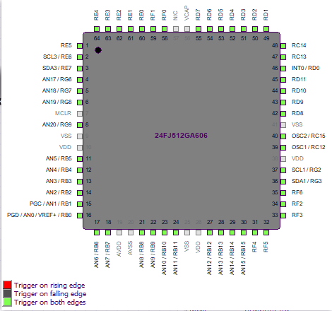

Thanks for your help.
FC9 is set to Light Mode. The text on the screen looks fine.
However, Trigger on Rising (RED) is not set. I want to set RD0(INT0), RD11(Remap INT1) to Trigger on Rising. Interrupt does not work.
thank you.
