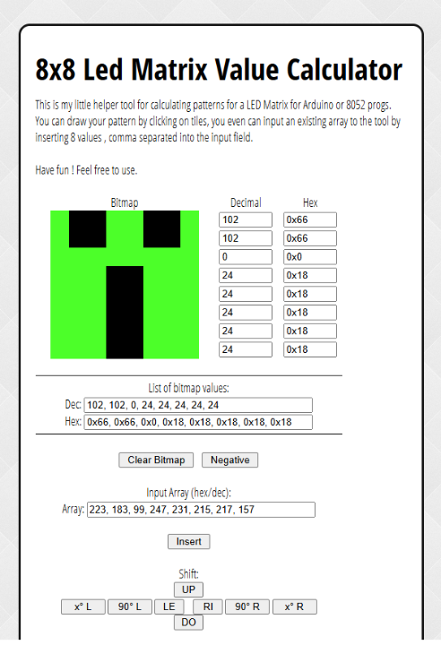

I can create these symbols with a calculator, but can I add these codes to a macro? Is there any way to do it myself?

No, not as it stands - all the characters are copied from the lookup table (which is in flash memory). How many characters do you need to add / replace? I can post the source to the component - all the characters are mapped in a lookup table where positions 0..7 correspond to ' ' (ASCII 32) - so need to know how the new characters map to the ascii character set too?

The character set is ascii 8bit (see https://en.m.wikipedia.org/wiki/ascii -) I offset this by 32 so it's a table of 768 bytes for 96 characters (96x8).
A string in flowcode is an array of bytes - so each character can be 0..255 so in theory it would be possible to support 256 characters - which would require 2024 bytes storage.
Can you post what you've tried this far?
