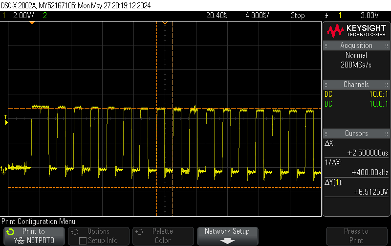

If i set the clock from LSM9DS1 to 400khz , the MCP9600 sets the clock to the wrong value, even also to 400khz, and it then the MCP9600 is not longer working.
Clock from MCP9600 is with 400khz to high!:

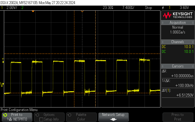

If i set LSM9DS1 to 100khz clock, the MCP9600 sets the clock to the to 100khz, and it then it's works nice.
Clock from MCP9600 is ok 100Khz:

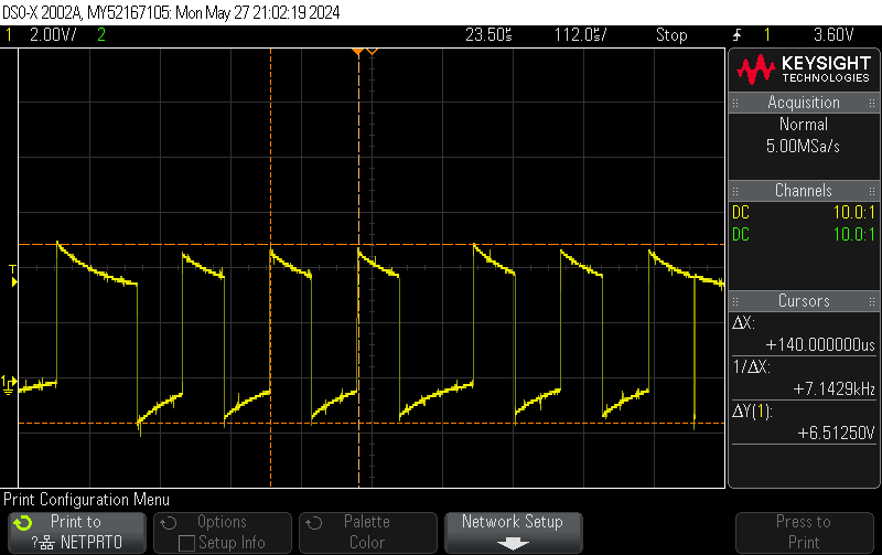

I also have tested the MCP9600 in software mode but then the clock is with 7.1429kHz very slow
