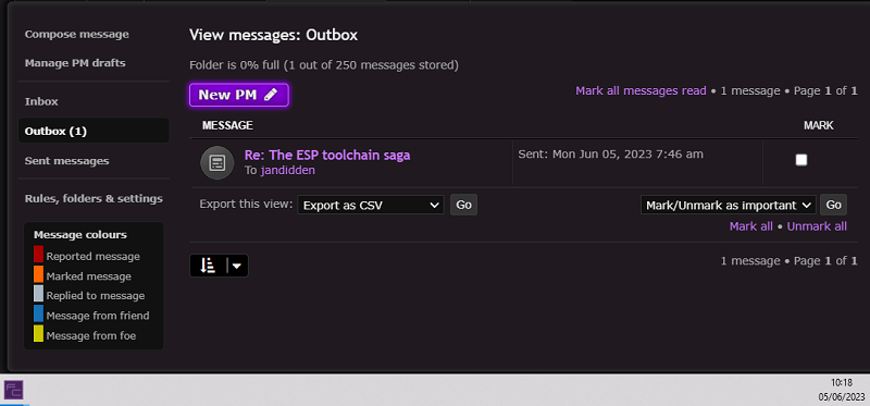

Hi Jan.
I replied to your PM about this at 7.46 this morning, and the message is still showing in the outbox.
PM Jan.png (104.39 KiB) Viewed 13924 times
As you have not read it, can you check that you can see the PM?
Many thanks for the spot.
That has now been corrected as the toolchain should only be downloaded from our website here
