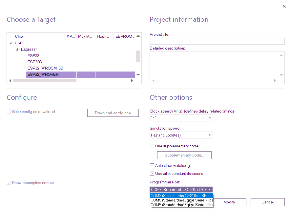

Yes I know this page. It appears right after starting a new project. All the settings I did correctly. So I don't know what else I should do now.

Hi Felix,
There is a little bug in Flowcode,
even if your COM4 is at the top of the "Programmer port" list,
you still need to click on it (to confirm the selection)
and then click the "Modify" button.
Please try that.
Please try that.

Look this video ,somehow you miss what me,leigh and stefan told a few times you have to explicitly set the comport

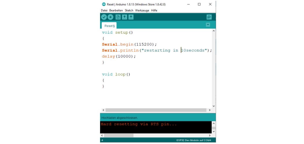

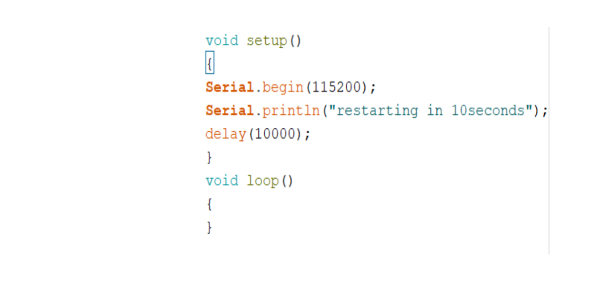

I had to reset them completely before the next programming by means of the Arduino IDE Plattform
The Programmcode, shown in my image, I found somewhere in the Internet
