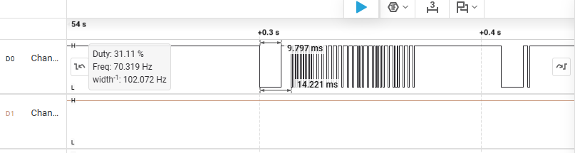

This is the 1 extending the signal
- Captura de pantalla 2026-08-19 224924.png (26.29 KiB) Viewed 5750 times

As far as I am aware, the Flowcode component is for RC5 encoded signals so NEC encoded signals won't work. Don't quote me on that as I am no expert in IR-RC protocols.
However, as you have a logic analyser you can figure out what you are receiving. You can see that the output remains high until transmission begins, therefore set your analyser to trigger on a falling edge, capturing an entire frame (until it goes back to high and stays there).
You will then be able to measure the duration and how many pulses are contained (including each pulse width).
With a "google" search you will find the format and difference between RC5 and NEC protocols, and can compare to what you have received. This will help you identify what is being used. This sounds far more complicated than it actually is. Once you have identified the protocol you can look at decoding.
PS
As far as I am aware RC5 is primarily used by European manufacturers and NEC by Japanese, but don't quote me.
Not sure I understand you. What screen are you seeing the "0" on? Do you mean you are just capturing the pulse train as displayed in your following posts?I found a transmitter and receiver in my Toy box—according to my checks—operate at 38 kHz. I displayed the signal received by the RX when pressing the "0" button on the screen. How can I get the PIC to decode the signal and identify that I'm sending a "0" with the TX

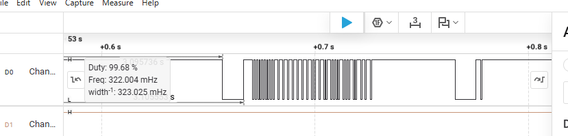

Hi Lein,
I’m not looking at screens; I’m pressing the '0' button on the IR remote I’m showing, and the signal I see encoded on the logic analyzer is the one you recommended I check. However, based on what you said, I think it would be better to use the Flowcode 11 component to avoid complications—that component comes with built-in macros, so it’s just a matter of connecting and programming. Could you tell me which component that is

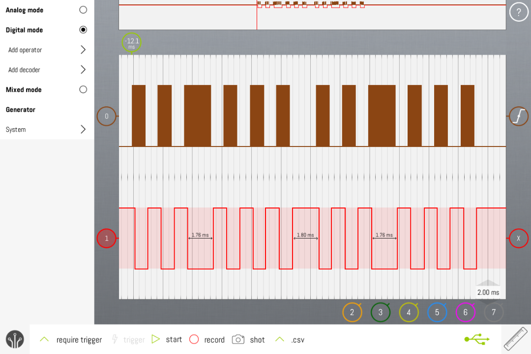

I'm still waiting on the 'receiver' PIC.
However - The transmit / decode (on Arduino) seems good.. I've made a few 'tweaks' to the decoder and I used a couple of transistors to toggle the signal pin on the transmission side.
Top line - transmission, second received signal:
