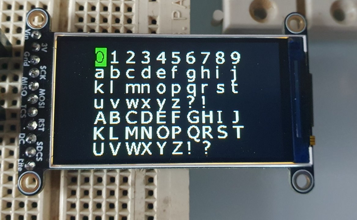

So background color is global on the whole display, and changing it needs to be followed by a ClearDisplay.
In contrast, changes in foreground color can be defined even on a pixel or any shape construct basis and does not need a ClearDisplay.
But I don't see any possibility to reverse a character that when it is white on black, change it to say blue on red.
That is not possible because you can't change background color locally. Or can you?
Jan
jandidden
Posts: 113
Joined: Mon Feb 13, 2023 7:56 pm
Has thanked: 28 times
Been thanked: 12 times
Re: ST7789 display
Post by jandidden »
Of course you can change background color locally: draw a rectangle or circle or ellipse and set transparancy and fill parameters appropriately.
So you can highlight a character in a soft keyboard by drawing a rectangle at the character position, printing the character in the drawn rectangle, giving it (the character) both a different background and forground color.
The original can later be restored to un-highlight it.
But when you have to highlight and un-highlight a string of characters (like when entering a password) you end up with a whole buch of different color rectangles all over the display, and I'm not sure what the impact of that is.
Probably need to reset the whole display to an initial layout after finishing the string selection procedure.
Jan

That looks great, and is very close to what I initially wanted to do.
One more step gets me there: a reversing character, see attached 8-)
So it looks that you can do a change of background color without a ClearDisplay and that then has only an effect on the next print (or plot?) command?
Which, in hindsight, does make sense.
Jan

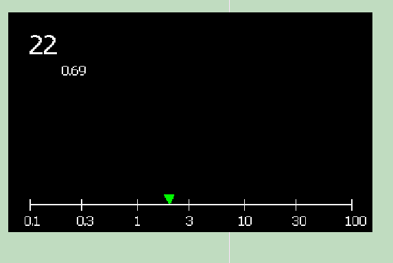

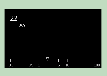

Another brain-teaser (for me at least). I need to display an arrow-like element in the shape of a triangle.
Like for a down-pointing arrow I'd have a small triangle with a horizontal base and two slanted down-oriented sides, see attached. Not a big issue, but I want to be able to fill such an arrow with a color as additonal indication, like green for underflow and red for overflow of a signal.
How do I do that flooding of the triangle?? FC9, ST7789 gLCD.
Jan

BTW The fill for an arrow works fine: just draw vertical lines repeatedly with an X1 offset.
See attached. Wonder if there isn't a more intelligent way ...
